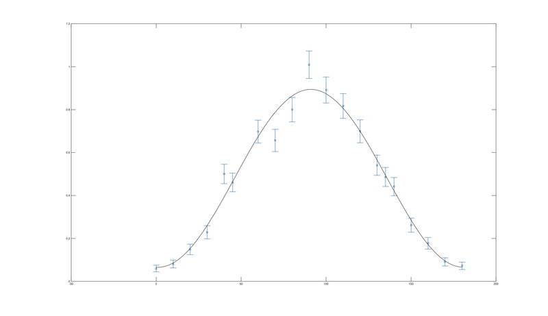

I have measured the incident number of electrons in a channel electron multiplier at different light polarization angles (a photoelectron angular distribution measurement). The events follow a poisson distribution and as far as I know the number of electron counts in a detector, C, has an error of ##\sqrt{C}##.
I have used MATLAB cftool to make a fit to the measured data using a ##\cos^2\theta## function with a few parameters, giving me a value of one of the parameters as $$b=1.82\pm 0.12.$$
It looks kind of like this (not the actual data, but they are similar).

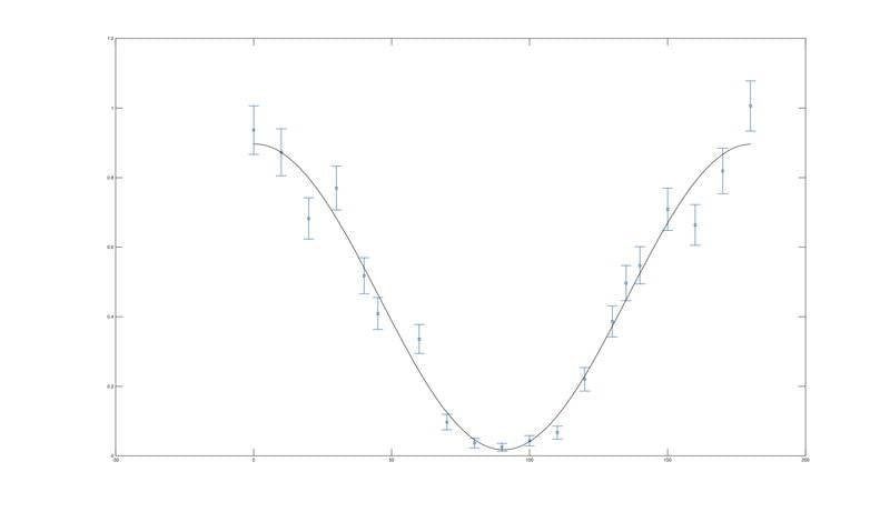

Another way to retrieve the value of ##b## is to use ##C_0## and ##C_{90}##, hence the maximum and the minimum values of the angular distribution as seen in the attached picture. That is, the counts at ##0^\circ## and at ##90^\circ##.
Problem
Assume that e.g. ##C_0=900 \pm 30## and ##C_{90}=9 \pm 3##, and that I calculate the value $$\frac{C_0}{C_{90}}=q \pm \Delta q.$$ I then want to use ##q## to calculate $$b=\frac{1-q}{q+0.5}, $$ how do I find the full ##b \pm \Delta b## and ##q \pm \Delta q##?

With your formulas and numbers, I get ##q=100## and ##b\approx -1##. Something has to be wrong.
Your uncertainties on C0 and C90 are uncorrelated. You can evaluate the uncertainty for both separately and then add them in quadrature. It will probably become asymmetric as your relative uncertainty on C90 is so large. Unfortunately that is not the correct asymmetry - because your estimate of ##C_{90}=9\pm3## is not correct. This is easier to see in more extreme cases: What if your count is 0? Does that mean your measurement has an uncertainty of 0?
If you know the expected photon count (from theory or whatever), then you have a sqrt(n) uncertainty on what you will actually see. But the opposite direction only works approximately for large counts. The number of photons you observe is exact - you saw 9 photons and not 8 or 10. To estimate the expectation value, you need the question "given a specific expectation value, how likely is it to see 9 photons?" Feldman and Cousins discussed this in detail in their paper. If you want a good estimate, you'll have to take this into account. If you just want a rough approximation how large the uncertainty is, just take up- and downvariation from the ##\pm 3## and make an average of them.

Thank you mfb for the reply, I see that I wrote the formula for 1/q instead of q, so that would give you the value b=2 instead.
I'll have a look at the paper and see if I can get a grip of it. Of course the ##\sqrt{n}## only works that far, and that my uncertainty doesn't go to zero as my counts go down...
