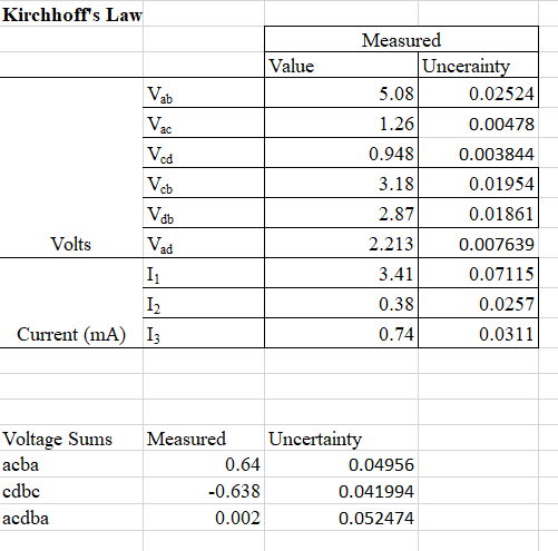

In summary, during a lab exploring Kirchhoff's Laws, a procedural mistake was made while measuring voltage values across different elements. The calculated voltage sums were correct, but two loops had almost perfectly opposite voltage sums. After considering potential sources of error, it was discovered that there may have been transcription errors or a common source of error causing the opposite errors in the two loops.
Elliott Pryor

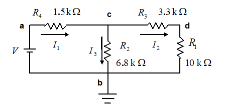

For a lab, we explored Kirchhoff's Laws. I made a procedural mistake while measuring my voltage values across my different elements. I know that all of my calculated voltage sums are correct, so I was wondering what I might have done to have loops ACBA and CDBC have almost perfectly opposite voltage sums?
Kirchhoff's Voltage Law: Around any closed loop the sum of the voltage changes is equal to zero.
I have no idea. Maybe I placed one probe at point B (the end of the circuit) and measured the voltage difference between each element and the end instead of across the element.

Look for transcription errors in your recorded measurements (or you may have transcribed digits when you initially wrote down a measurement).
It may be significant that you have opposite errors of the same magnitude in two different loops. It suggests a common source for the error. What would be a common source of error for the two loops?
Thank you! I never noticed!
