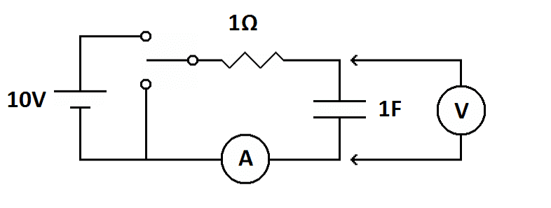

Thanks for reminding me of the switch. Yes, I need a switch. Why the resistor will go to a different place?
No, I am not sure about the resistor values. But I think that those should be quite high. The circuit should be a simple series circuit with all the components in series. I can upload a picture if it helps.
Yes, it would be good to see a sketch of the circuit that you have in mind.
The resistor would go in different places depending on whether you are measuring the discharge time or the charging time. If you are measuring the time it takes to charge the cap up, you would connect these in series: Battery, switch, resistor, capacitor. You close the switch and measure the time to reach 63% (or whatever percentage you want to use for your RC formula) of the battery voltage.
If you want to measure discharge time, you would connect the resistor and cap in parallel, and then connect those to the battery through the switch. You would close the switch and let the cap charge up (relatively quickly, depending on the output resistance of the battery), and then open the switch and measure the time it takes to fall to 37% (or whatever) of the battery voltage.
If you want to get fancy, you could figure out how to use a single pole double throw (break before make) switch to be able to measure both the charge and discharge times... :smile:

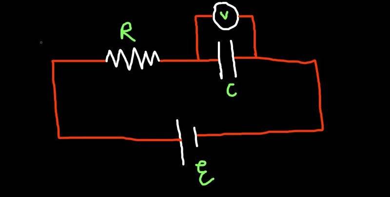

Sorry for being so late. I was loaded with college assignments. I am attaching the circuit diagram. Please forgive my disastrous drawing.

That works for measuring the charging time constant if you put a SPST switch to the left of the battery. :smile:
Likes ARoyC
And for a circuit like I described using a SPDT switch (break-before-make) to alternately measure the charge and discharge times, you could use something like this (with better R and C values, and you don't need the Ammeter so just short it out):
https://rsdacademy.net/textbooks/dcelectronics/Part5/CapacitorDemonstrationCircuit.png
Likes ARoyC
Yes, sorry. I have to add a switch. Then by calculating the time constant, won't it be possible to calculate the capacitance?
ARoyC said:
Do I have to do the discharge to recheck my calculated value?
You need to fully discharge the capacitor before you measure the charging time constant waveform. And similarly, you need to fully charge the cap before you measure the discharge time constant waveform.
Alternately, you need to use the starting voltage for either one in your calculation, and not just assume the capacitor starts at 0V and Vbatt for the two transients. Does that make sense?

Why won't the capacitor start at 0V and V_batt if I discharge it fully?
I don't understand the question. In the circuit you posted, if you put a switch in series with the battery, the first time you close the switch you will be able to measure the charging time constant. But disconnecting the SPST switch does nothing to discharge the cap, so unless you have some other way to discharge the cap (like the SPDT circuit), you only get to do the experiment once.
Likes ARoyC
Yes, that I understand. I need to construct the circuit in such a way so that I can discharge it. And the SPDT circuit is needed for it. Probably I asked the last question due to a misunderstanding.
