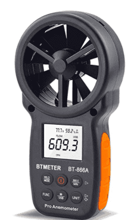

Are you sure? 60 seconds of search found this on Amazon for $40. It says 0-40 m/s range.
He's asking for higher than 40m/s.
OK, here's one that claims 100 mph (44.7 m/s)
This one claims 50 m/s

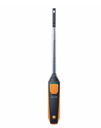

Here's one using a hot wire, claims up to 68 m/s
Searches for airspeed sensors in aviation sources should easily find more products with ranges higher than 40 m/s.
