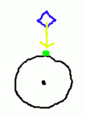

A statite hovering at two Schwarzschild radii from a black hole drops a probe into the hole, and shines a clock signal inward after it. The probe knows its position relative to the event horizon. What is the last time on the clock received by the probe while outside the event horizon?
To keep things "simple", the black hole is 1E30 kilograms. The statite (stationary satellite, blue) hovers above the hole at a fixed location (twice the Schwarzschild radius from the singularity) by tremendous acceleration. The statite drops a probe (green) that begins to fall toward the hole at t=0 s. The statite beams a signal (yellow) with a different time stamp for each second. The probe can figure out how close it is to the event horizon, and beams that information back to the statite, accompanied by a mirror reflection of the last time stamp it received.
1) What is the last timestamp received by the probe while it is outside the event horizon? (Are there any timestamps not received?)
2) When is the probe's transmission of its last timestamp received by the statite?
Please feel free to explain very simply how you set up a problem like this.

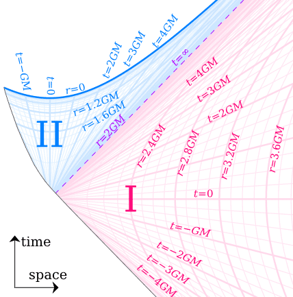

@PAllen - your argument *is* valid if there is in fact a last received signal. That's why the question is about how you calculate what the last signal received by the probe is; if someone can show there is (or isn't) a specific cutoff, the qualitative arguments ought to be settled also.
There is. This can be trivially seen in, for example, Kruskal coordinates. I am 100% sure @PAllen knows this.
The coordinate system is a big part of the issue. I don't have a deep understanding of Schwarzschild coordinates, but they seem "honest", whereas as I understand it the Kruskal coordinates describe the finite proper time of a hypothetical object falling into a black hole that is fixed and immutable for all eternity. Here, however, we're not looking at proper time, but at the time it takes relative to the frame of relatively "ordinary" space.

whereas as I understand it the [https://en.wikipedia.org/wiki/Kruskal–Szekeres_coordinates](Kruskal coordinates) describe the finite proper time of a hypothetical object falling into a black hole that is fixed and immutable for all eternity.
No. The chart whose coordinate time is the same as the proper time of an object free-falling into an "eternal" black hole from rest at infinity is the Painleve chart.
Kruskal coordinates do describe an "eternal" black hole, but so do Schwarzschild coordinates. If you are concerned about how your coordinates describe a black hole that eventually evaporates, you are going to have that issue no matter what chart you use; but Schwarzschild coordinates are still the worst choice you can make, for the reason given above.
