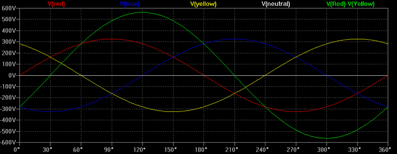

Here is one cycle of three-phase voltage, with the difference between red and yellow.
The individual phases are each 230 VRMS to Neutral.
Could you please help me to replicate the same what you have created, i think it is done is Ltspice? Could you please share the model? This is the circuit i have created.
There is a related question i wanted to ask before that i want to clear this, to get difference of the sine signals, do i need to use opamp circuit in Ltspice?
The output is simple sine waves with 120 Deg phase shift.
There is no op-amp needed. To plot a differential voltage, click and hold the node, then drag to your choice of reference voltage. You can also edit the graph titles and equations in the plot window.
Attached are .asc and .plt files. Remove the extra .txt extension that allows the text files to be attached to the post, then they will run as LTspice.
Note that I used Run, then Tools, Copy Bitmap to Clipboard, then I edited the image to relabel millisec to degrees, using the degree symbol from my Neutral label.
Also, it may be needed to set the horizontal axis to 30 deg ticks.

Considering that a voltage is thought of as a DIFFERENCE in potential you can think of a voltmeter as a subtractor. Apply the probes to the points in question and it tells you the voltage between.

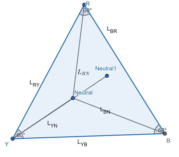

Thank you for the help, the main question i am facing is, i am involved in a testing and the setup has knobs to change any of Phase - Phase voltages ex: RY, YB, BR. The corresponding voltages are displayed on the same unit, so it is power supply and a display unit. Now i have taken few readings which i am not able to understand,
RY YB BR
481V 478V 482V -> Initial set voltages
452V 478V 452V -> Changing the RY voltage to 452V changes BR to 452V automatically, YB remains same.
400V 478V 400V -> Changing the RY voltage to 400V changes BR to 400V automatically.
Similar phenomenon happens for other phases if i change one particular phase, one other particular voltage changes and one voltage does not change.
I don't see the 3 phase voltages add up to 0 in the 2nd case and 3rd case. Does it mean the 3 phase voltage is imbalanced or anything that i am missing? The RY, YB, BR are assumed notations.
Draw a triangle with all internal angles equal to 60°. Label the corners R, Y and B. Make the edge lengths equal to the phase-phase voltages. Since the triangle must close and the phases or angles are fixed, there is a dependence between the edge lengths or voltages.
The neutral will be near the centre of the triangle. If you change one neutral to phase voltage, then two associated phase-phase voltages must also change.

Sorry for delay, i tried hard to understand how do i approach, when i have to maintain 60 degrees,
if i shift the Neutral point to Neutral1 point, the lengths of L_RY, L_BR, L_YR will still remain the same. Can you please give one hint to proceed further, I am struck.

While 60o is the nominal phase difference, it won't always be that in unbalanced cases. A triangle with 3 60o angles must be equilateral. You have a triangle with 400, 478, and 400 sides, that one will have angles of 53o, 53o, and 73o.
https://www.calculator.net/triangle...&vy=400&va=&vz=478&vb=&angleunits=d&x=69&y=16

I may have confused you with the deviation from the ideal equilateral triangle.
Start with neutral at the origin. The reference phasor is drawn along the +x-axis. The other two phasors, lie on radial lines from the origin, spaced 120° from the x-axis.
Measure the three phase-neutral voltages, then plot each along the appropriate 120° radial. Join those three points to make a triangle. The edge lengths should then equal the phase-phase voltages.
If you have only the phase-phase voltages, you can draw a triangle with those edge lengths. Then drop that triangle, so the corners fall on the 120° radials. The distances from the origin to the points are then the phase-neutral voltages.
It appears that when you change the RY voltage, it is actually changing the RN voltage, which is why the BR voltage also changes in the same direction as RY.
Maybe the knob on the power supply that you thought changed RY, actually changes RN only, with implications to both the displayed RY and BR.
