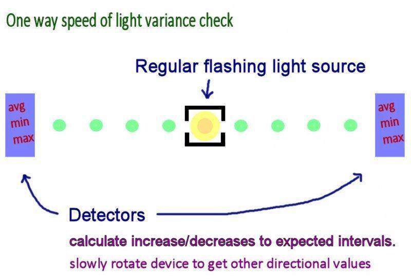

Here's a proposed experiment which I could not find any evidence of this being performed before..
Central light source pulsing opposite directions at highly regular intervals. Two detectors, one either side at equal distance. Both detectors measuring 'jitter', ie. by looking at the timing between the pulses the detectors can determining a minimum and maximum value difference. These differences can be mapped while turning the device through 360 degrees, thus would very quickly highlight any differences in light speed in certain directions.
special relativity says light is 'independent of the state of motion', thus this experiment should be able measure movement? And if so, what movement would it detect say on the space station? Speed around the earth, speed around the sun, speed we are moving through the galaxy?

You need to much better describe your proposed setup. As I understand it, it will detect nothing. It does not appear anyone understands what you have proposed. Perhaps start by explaining in detail what you mean by measure jitter, and upload a picture of your proposed experiment. Be as precise as you can. Your OP is completely imprecise and incomplete.
I agree with PAllen, the setup is ill-defined, or at least ill-described. Nevertheless, it won't work. There are three things you need to know to predict the time that a clock will read when a light pulse hits it - the distance to the source, the speed of light along that path, and the clock synchronization convention. In doing the experiment, you measure two numbers: distance and time. In short, you have too few measurements to constrain too many variables: two equations in three unknowns.
Adding complexity is increasing the number of measurements, but each new measurement suffers from the same problem as the single measurement, so it doesn't matter how complicated a setup you use. There is simply not enough information to determine both the one-way speed of light and the clock synchronization convention. In the Einstein clock synchronization convention, where clocks are brought together, synchronized, and then slowly moved to their final position, the speed of light is isotropic.
attached a sketch
I should add that its not attempting to measure the speed of light, but to measure the (one-way) differences depending on direction.

I had misunderstood the setup. I thought he was going to compare the pulses received at the two arms. This can either be done by "comparing the video tapes" or "side-by-side live CCTV", which is where my post was coming from.
All the rigs have variants on the same problem, of course.
@seb7 You should study the Edwards synchronization convention. It has isotropic 2 way speed of light but anisotropic one way speed of light. You can transform from a Lorentz frame to such a frame. Since it is just a coordinate transform, none of the invariants differ.
I think I understand the thinking behind this experiment. And I also understand the flaw in its design.
We have an inertial light source, equipped with a clock, which emits pulses of light at regular intervals according to its clock. In fact we need only one receiver, equipped with its own clock, that moves very slowly in a circle around the emitter. Both the emitter and receiver plot graphs of pulse count versus their own elapsed (proper) time.
The emitter's graph will be a straight line. With isotropic one-way light speed we expect the receiver's graph to be a straight line, too. But with anisotropic one-way light speed, the experiment designer expects to get a curve. On some parts of the circle the pulses should arrive sooner than expected, and at the diametrically opposite points, later than expected. The receiver's graph would deviate from a straight line by a roughly sinusoidal perturbation, the designer argues.
What's wrong with this?
There is a hidden assumption that the motion of the receiver's clock does not invalidate the measurements. We know that clocks in relative motion may lose their synchronisation to each other. That's the well known "twin paradox". But, surely, if the receiver moves slowly enough, these effects become negligible? It's true that the time dilation factor ([itex]\gamma[/itex]) decreases towards 1 as the speed decreases to zero. But the time taken to complete a circle gets longer (in fact, towards infinity!) as the speed decreases, and this increases the dilation effects. The decrease and increase tend to cancel each other out so that the relativistic consequences of motion do not become negligible.
Let's suppose there are a number of inertial clocks all distributed around the circle, at rest relative to the central emitter. As the receiver moves round the circle, each of the fixed clocks gets synchronised to the moving clock. The experiment then becomes equivalent to using these fixed clocks to measure the one-way speed of light. This method of synchronisation is called "slow clock transport". It can be proved that synchronisation by slow clock transport gives exactly the same result as Einstein synchronisation (which, by definition, guarantees isotropic one-way speed of light). (See discussion, and references, at One-way speed of light.)
The conclusion is that this experiment can't detect any one-way anisotropy (assuming two-way isotropy is already established).
