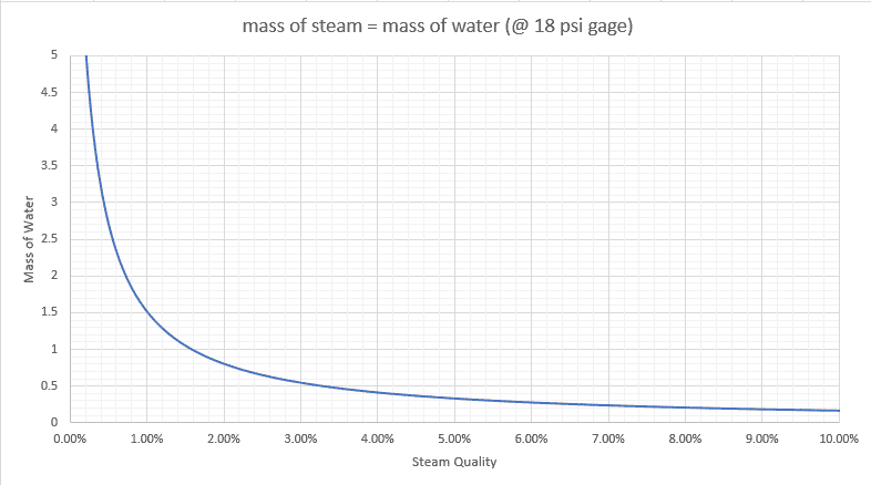

Update with some comparative data.

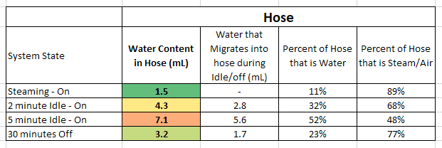

I was able to isolate and collect the condensate in my "Hose". What I collected was on average 1.5 grams.
By a 'Theoretical Definition', I could map out Steam Quality for Saturated Steam Mixture at 18 psi (shown below), and match the mass of Water (which equates to mass of Steam and eventual mass of Steam Condensate at Room Temp), and back out a Steam Quality. 1.5 gram of Steam, yields a quality of 1% based on my 'Hose Volume' (1.36e^-5 m^3).
This is inaccurate and not representative of my actual Steam Quality obviously. The main incorrect assumption may be what @jrmichler , pointed out - All water would have to come in contact with the heater for full heat transfer / conversion to Steam. It is evident visually and by some more data that I've taken that liquid water is making it's way past the heater in my system. So I think that's most of where this 1.5 grams is coming from.
Question 1) Is the above accurate?
Now for a more practical estimation of Steam Quality. Maybe somebody can help me understand if I'm interpreting this correctly.
By a 'Instantaneous Definition' of Steam Quality, I would take the Total volume of the Hose, subtract the volume of Steam Condensate collected, and divide by the Total volume of the System. If I do this, I end up with 89% [ (13.65 - 1.5)/13.65 ]. This seems pretty accurate based on how my steam looks and feels - i.e. 89% vapor, 9% liquid.
I have pause calling this Steam Quality though because it's more describing the mix of Wet Steam + the Water that escapes past the heater, but maybe it truly is Steam Quality?
By an 'Averaged Definition' of Steam Quality, I would make this calculation over a longer period of time. Taking the Total Volume that I feed the heater, subtracting the Steam Condensate that I collect (via spraying steam over a large pan and letting water droplets fall out of suspension), and dividing by Total Volume fed. For example (hypothetical numbers), running 10 minutes at 70 mL/min would mean 700 mL of water. If I collect 50 mL, that would result in 93% [ (700-50) / 700 ].
Question 2) For anybody well versed in the Steam Industry, can I get away with calling either of my estimations above, 'Instantaneous' or 'Averaged', as an actual representation of Steam Quality?

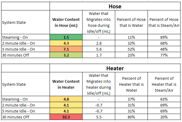

Bonus for anybody interested: Here is where I netted out with water collected in different areas and different conditions.

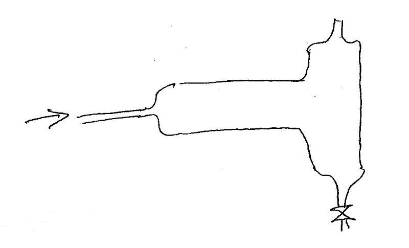

There is a better way to measure steam quality from your setup. Try this procedure:
1) Assume 60 ml/min, 100% heat transfer, and 800 watts. Calculate the amount of steam and steam quality.
2) Connect the output of your steam generator to a steam separator. The steam separator is a T-shaped insulated piece of pipe as in the rough sketch below:
The steam enters from the left, presumably at a velocity that mixes the water with steam. It enters the larger horizontal pipe and slows to a velocity slow enough that the water drops out. Using the steam quantity from (1) above and atmospheric pressure, calculate the pipe diameter that allows this to happen. I would guess that a steam velocity of about 3 m/sec would work.
3) Run the system with the drain valve open until it is fully heated up and you have stable operation. Then close the drain valve and start your stopwatch.
4) After an appropriate time interval, disconnect the supply line, stop the stopwatch, and measure the amount of water in the steam separator. You now have a reasonably accurate measurement of the amount of water entering the steam generator, and the amount of liquid water leaving the steam generator. The difference between those two is the amount of steam that exited through the top vent.
