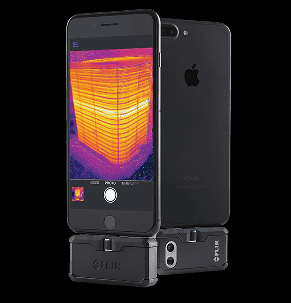

We have had good luck with the FLIR ONE IR camera adapter for smartphones:
https://www.flir.com/flir-one/
We were mostly looking for hot spots, though, rather than using it for absolute temperature measurements. Have a look through the datasheet to see how close you can get to the object and what kind of accuracy you have when you select a region of the image (your via).
The via is open.
Thanks for the suggestion on the FLIR ONE IR camera. I've tried the same camera as well as a handheld E-series from FLIR and I'm not able to get a good reading. To get an accurate reading, one of hte stipulations is that the object needs to be larger than the spot in the crosshairs. The minimum distance the camera can be from the object is 1.6 feet (0.5 m). At 1.6 ft, the via is a lot smaller than the spot in the crosshairs.
Hmm. How big is the spot in the middle of the crosshairs at the minimum distance of 1.6 feet? If it's not too big, you may be able to place an IR magnifying lens between your PCB and the camera to enlarge the image.

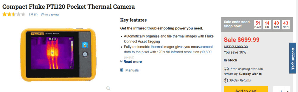

What is the expected temp, accuracy and what bandwidth does the measurement require?
For me, the cheapest and simplest way is one of the hand held IR thermometers from fluke. They're usually tuned to the emissivity of metal too.
https://www.fluke.com/en-us/learn/b...et-great-results-with-an-infrared-thermometer
If it has a 12:1 ratio then you could hold it 6mm above the 0.5mm via to get it's temperature. It will probably achieve like +-5C accuracy over 0C to 150C range.

We use that too. Keep in mind that the projected spot is not very well aligned at short range with the spot being monitored. For our Fluke IR thermometer, the spot being measured is a bit below the projected red dot. You can usually just scan in x and y directions slowly to zero in on getting the measuring spot over the hot spot.

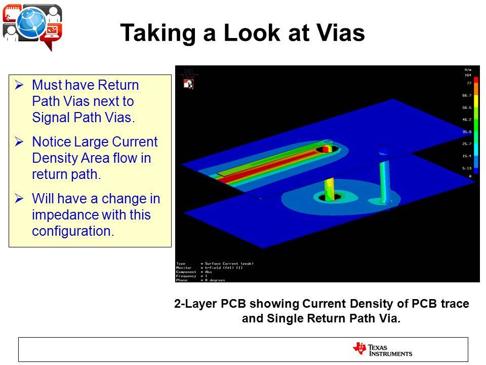

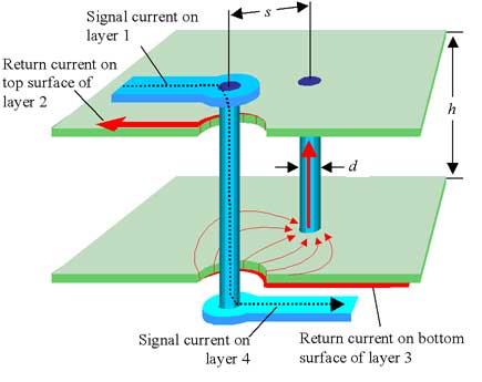

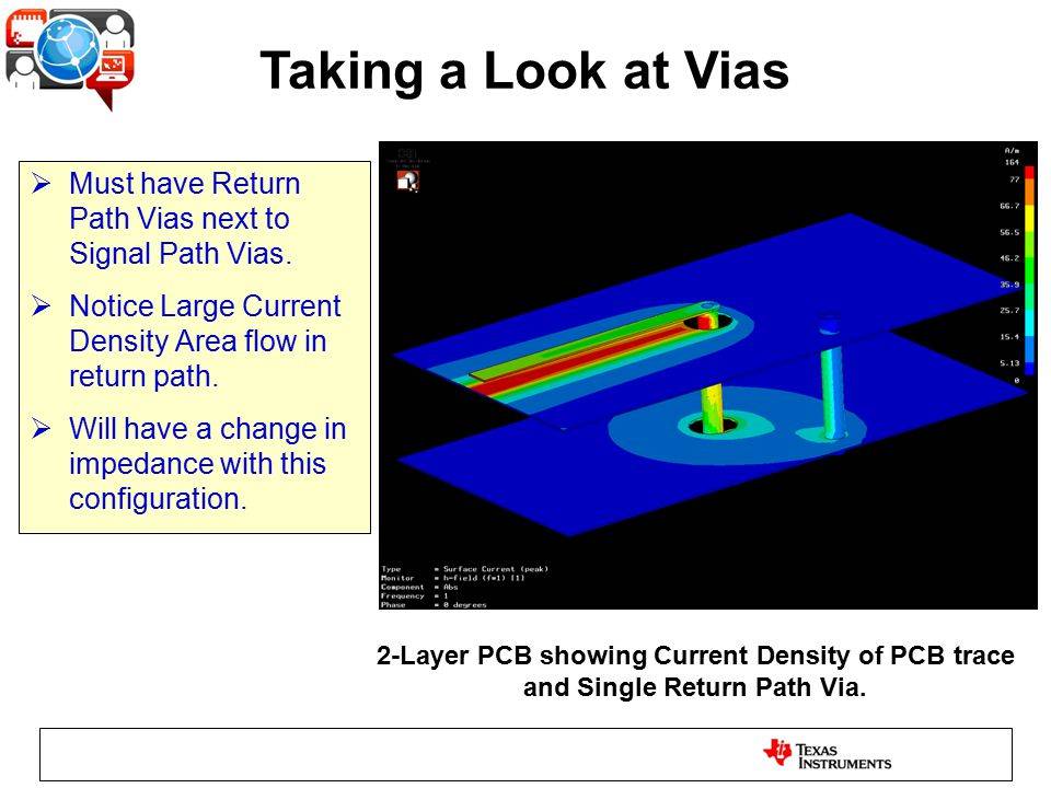

Thanks for the suggestions everyone. I'm going to order my test boards with different via sizes as well as low-mass thermocouples. The lenses are a little pricier, but I'm going to speak to the company and see if they think it may work for this application.
Here are a few images that I pulled from google which sort of show what I'm trying to view investigate. On the first image, they're not really showing current density but just imagine they are. That's the thermal calculation that most are using. The assumption is that current is uniform throughout the trace and the via. The second image is showing the actual current density of the via. If we average current over an area then we can estimate temperature as a function of average current, but it would be more accurately explained as a function of current density. That's why poor electrical connections lead to higher temperatures, right? So what I would like to do is view the difference in temperature throughout the via if possible. At the very minimum, it would be nice to look at several via sizes and see how the temperature changes.
I may have to go with larger vias for testing, get a good fit with simulation results, then rely on the validated sims for more complex designs which would include smaller vias.
Baluncore
I'm interested in more than the average temp because if PCBs degrade due to temperature, wouldn't minimizing local hotspots increase the PCB lifetime (only considering the thermal side of things)? I think that only considering average temperatures may be a shortcoming. I know it's easier and more practical though.

The PCB's Tg=180 C so I'm expecting this to be below 200 C. For the Fluke, wouldn't the laser have to be the same size or smaller than the via? I've only used those several feet away but it seems like the laser was quite a bit larger. Do you know if it's can get that small? I think this is going to be quite the challenge so I'm open to trying different methods. At the end of the day, whichever method words best and matches up closest with sims may be the one I have to keep.

That's good to know about the EMI issue for future references. This will be DC so at least that's one less challenge I may have.

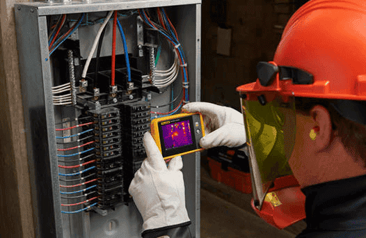

A bit off topic, but that panel looks like someone like me that is slightly OCD wired it. Those are some very neatly arranged wires and connections.
Not terribly unusual in industrial equipment, it makes maintenance A LOT easier; house wiring, yeah, to the point of non-existence.
Yeah I've noticed that industrial is always more neatly done. I've seen some built up control panels that look like art. And the types of panels I'm referring to are one offs. Not like someone had several hundred of the same to practice on.
Not OCD in our equipment. If you were a technician in our Lab, back in the day, this is what I would want you to do. It's more inspectable and servicable, and it isn't really any harder to do it right once you are used to doing it.
