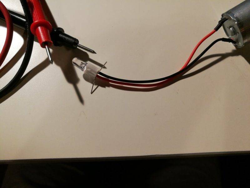

I am performing an experiment where I have built a scale model of a wind turbine, and am measuring the current it can produce with a micro generator. I am using a standard multi meter and the micro generator is DC. I do not know much about the topic, but whenever I start measuring the current, the turbine slows down significantly and reduces the current. By my understanding, the ammeter function should have very low resistance and allow current to flow through the circuit like normal.
I am also trying to calculate the power produced by the windmill by the equation P=IV, where the voltage is unaffected by my multi meter measurements. Should I ignore the windmill's readings as its current decreases and multiply by its maximum current values? How does a real windmill generator work compared to this?
See "short circuit."
That makes sense, thank you. Should I therefore take the average, maximum current values the multimeter presents and multiply by the voltage to get the most accurate representation of it's power output?
What is the voltage of a "short-circuited" generator? You might want to try a known resistance, "load," and vary that until you get a stable set of simultaneous voltage AND current measurements.
I measured the maximum currents by allowing the turbine to spin up to maximum velocity, then touching the multi meter to see the initial current measured as the generator "short circuits." I am taking the voltage values from an average of the measured voltage using the multi meter as a voltmeter. There is a light bulb attached to the circuit with a measured value of 72.6 ohms, but I have no idea how to create/vary a load. Is the method I mentioned before not acceptable?

I believe it is the "cold bulb" resistance. However, when I try to measure the current through the bulb while the turbine is operating, it short circuits. Do I need to attach an extension with a small resister to add more?
Measure the current by placing the meter in series with the bulb, NOT parallel; measure the voltage in parallel.
This might be a stupid question, but in order to do so I must strip the red wire slightly?
I'll assume you have a single circuit, bulb plus generator? You'll need to insert a "current sensing resistor" in series with the bulb; this requires actually cutting the wire. Is there any problem with that? You can then measure the voltage drop across the current sensing resistor, calculate the current, I=Vsense/R, then look at the voltage drop across the bulb, Vbulb, and calculate the power, Pbulb=IVbulb. The current sensing resistor needs to be small enough that it doesn't appreciably reduce the current, but it needs to be large enough that it yields a measurable voltage.

Okay, thank you so much for your help!
