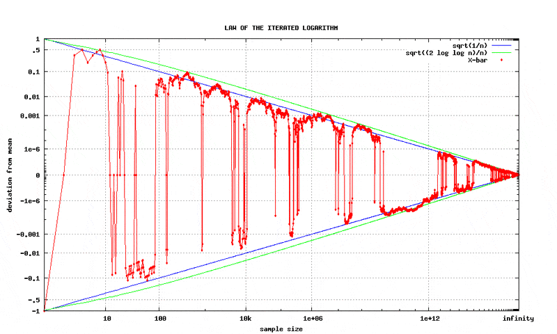

https://en.wikipedia.org/wiki/Law_of_the_iterated_logarithm
For any distribution which has zero mean and unit variance, if you take means ##S_n/n## and increase the sample size, then the bound you are looking for is
[tex]\frac{\sqrt{2n\log\log(n)}}{n}[/tex]
in the following sense: it has been proven mathematically that only finitely many values for ##n## will have the property that ##S_n/n## will surpass this bound, while infinitely many values will still come close to this bound.
For the means of a Bernouilli variable, this means that the bound for ##|S_n/n - p|## is ##p(1-p)\frac{\sqrt{2n\log\log(n)}}{n}##. This is maximized for the worst case scenario of ##p = 1/2##, which gives us a bound of
[tex]\frac{\sqrt{2n\log\log(n)}}{4n}[/tex]

Thanks for this @micromass – very helpful!
