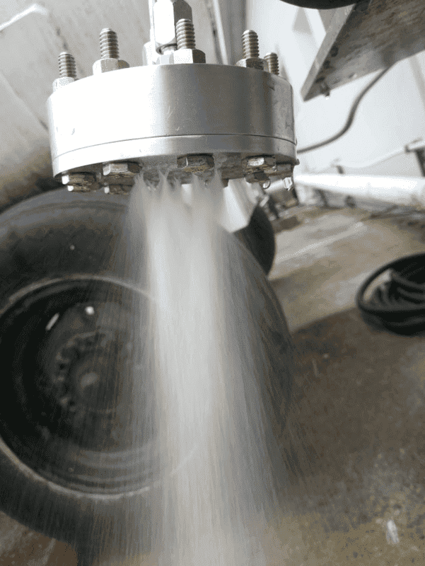

Hello @JBA. I don't have a nozzle attached right now. I only have the injector, and yes, PT21 and PT31 are relatively close to it.
244904
(Cold flow at Zucrow Propulsion Lab two months ago)
PS: I manged to fix the response time issue.
