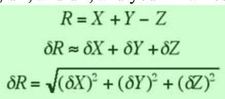

I have been preparing for a physics practical on diffraction. More specifically, we will use a CD as a transmission grating (by peeling off the reflective layer), and measure the distance between the fringes for a specific distance between the CD and the viewing wall. However, it is unclear whether we should measure the distance between the two 1st order fringes and divide by two, or measure the distance from the principal maxima to the left 1st order, and then from the principal maxima to the right 1st order, and take the average. Which is more suitable for this experiment? I believe that there is no great difference, since the absolute uncertainty remains the same in both cases.

Thanks for fixing the LaTeX. Uncertainties don't add the way you show. You need to consider error propagation. See here for example. In the second procedure you add an extra uncertainty due to the measurement of the central maximum.
On edit: I used the coin example to illustrate that the determination of the radius is more accurate when you eliminate the uncertainty of finding the position of the center which is what you have to do here.

Did you read "Addition of measured quantities" in the link I posted? Apparently not. Please read it first and then calculate the uncertainties.
Likes KDPhysics
We're allowed to use the second formula (##\delta R = \delta X + \delta Y + \delta Z##).
OK then, but let me ask you this. Suppose that you measure the two first order maxima from the center and you find that one is at a greater distance than the other by more than your assumed uncertainty. What will you conclude from that?
Likes KDPhysics
Ok, I think I got it. Since one is slightly farther away from the other, we should calculate the half range:
$$\frac{x_r - x_l}{2}>\delta x$$
assuming the right measurement is greater than the other. Then, we should be using this value as our uncertainty, which is greater than ##\delta x##. We can therefore conclude that measuring from one fringe to the other will decrease uncertainty.
Is this correct?
Yes. That's the idea I tried to convey with the coin example. I have edited that post to make it clearer.
