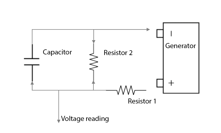

Borek the reason I am trying to avoid a multimeter is this device is harvesting vibrational energy so I am not getting a constant power output. I want to be able to record the output over a period of time and then compare it to accelerometer data to get mechanical power in.
Some preliminary measurements show voltages peaking at around 6 Volts. I'm definitely on board with using the voltage divider that both Borek and Asymptotic have suggested.

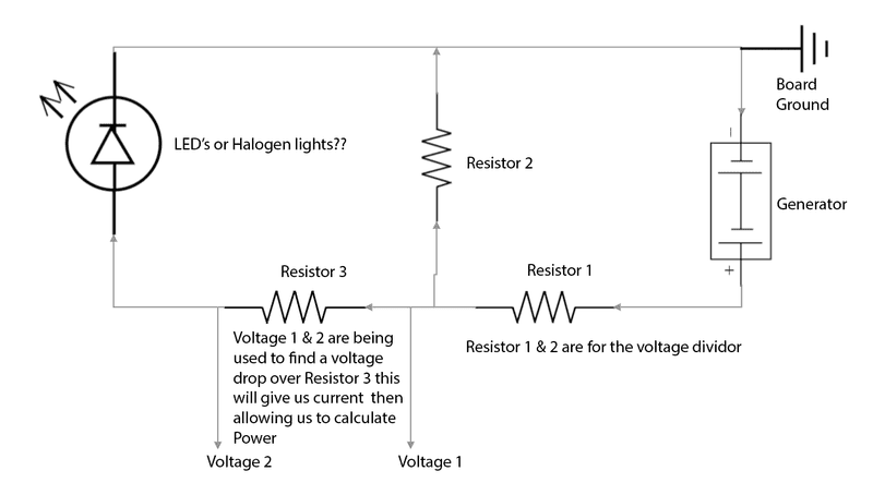

Ok so if I understand the both of you correctly this is what is need:
thanks
The right side of R3 should be moved to the battery/generator. Load current should not flow through the divider used for voltage measurement. You are on the right track.
I would have the Gen feed a capacitor (as a filter) and parallel known ( higher precision) resistor, then just measure the voltage across the resistor over time using P= V^2/R. I do not think measuring V and I will be much more accurate, without a precision instrument and the measurements have to be very well synchronized to be accurate.
Averagesupernova, I'm not quite sure what you mean. Could you elaborate? My understanding is if I move the resistor I will not be able to measure voltage as it is too high?
Windadct, do you mean something like this? I would still need a voltage divider, no?

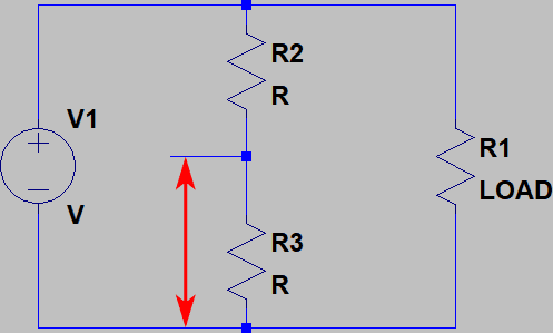

Put the voltage divider parallel with the load. Use the resistors for the divider so that the current through them is in the (at most) μA range - high enough for measurement, low enough to not heat it up - R2+R3 >> R1.

@Borek, ok that makes sense. If I understand you correctly R1 is the load and R2 & R3 are for the voltage divider. Any suggestions about what R1 should be LEDs or halogen lights? Are there any key things I should be looking for?

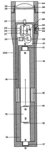

@Asymptotic, I think the best way to describe it is similar to a shaker flashlight. Both accelerometer and (hopefully) power data will be captured by the Arduino. As for sampling rate, I have been working with every 10th of a second and that seems to be fast enough for now.
-Thanks

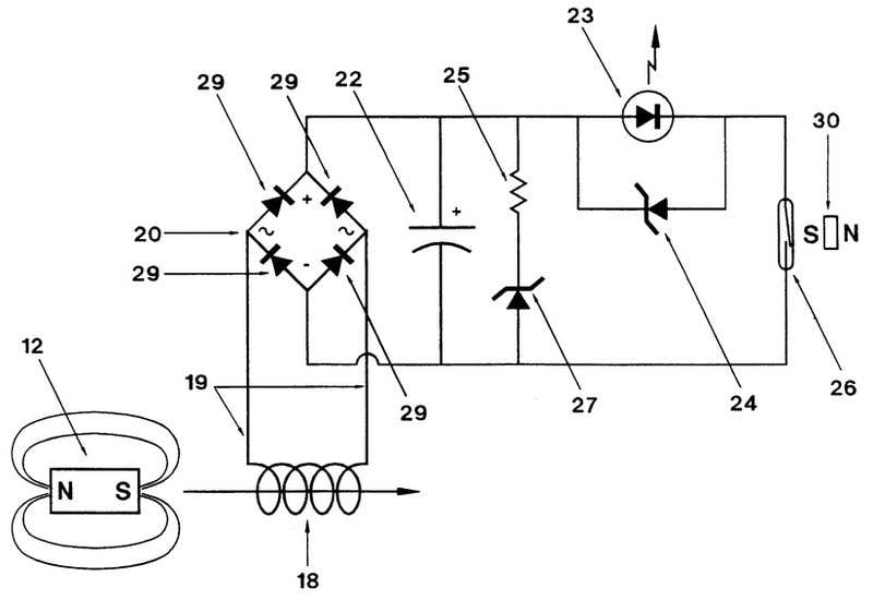

A coil wound around a hollow cylinder, a cylindrical magnet within, and either springs or oppositional magnets at both sides of the cylinder?
Something like this (from patent #US 6220719)?
This is an AC generator. DC is produced using a full wave diode bridge.
Yes.

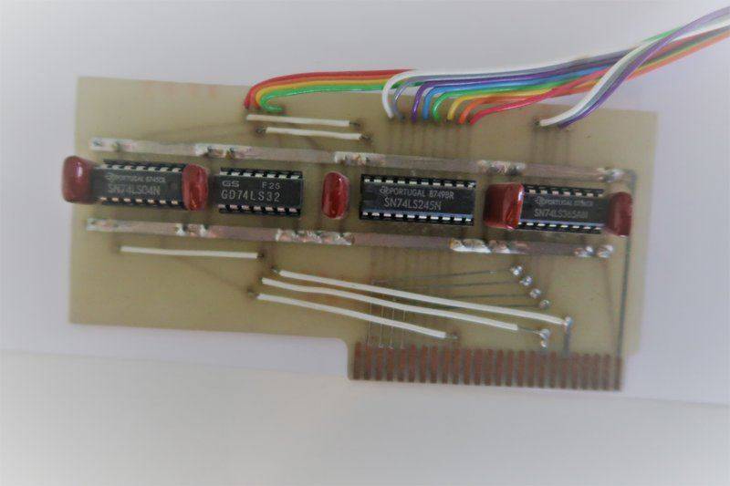

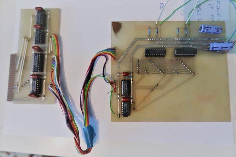

(3) I built an analog to digital board for my Apple II many years ago . With my DIY software this could be used to capture data and give quite useful meter and scope displays . It worked very successfully until just a few years ago when the Apple II finally died of old age . If you want a nice and very practical project you could build a modern day version . There are published designs and kits available to get you started .
Likes Total_Insomnia
The smaller board is for plugging into one of the Apple II expansion bus slots .
