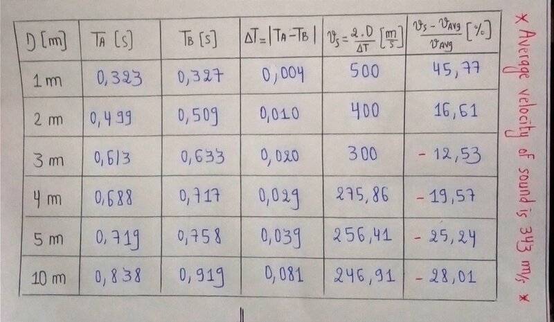

Which one seems logical and correct ?​
this one:
[ Normally when we increase distances, the velocity of sound decreases?]
Or this one?
You might wonder why. Well, my friend in class told me that the second table could be correct because the experiment was conducted at closed home under suitable conditions, where the average speed of sound is around 343 and the calculated speed is approximately 333, which is slightly lower than the standard value but still within a reasonable range of deviation so somewhat acceptable within the limits!
and she told me also that in home, when we increase distances, the velocity of sound remains constant. This is because the speed of sound in a medium (such as air) is determined by the properties of that medium, and not by the distance traveled within it.
could you please help me!
No, of course not. The speed of sound in air depends on the air temperature, pressure, humidity, etc., but certainly not on distance through air with those variables held constant.
The more likely issue is that when you are trying to use a simple measuring apparatus like cell phones, the closer the distance the higher the error...

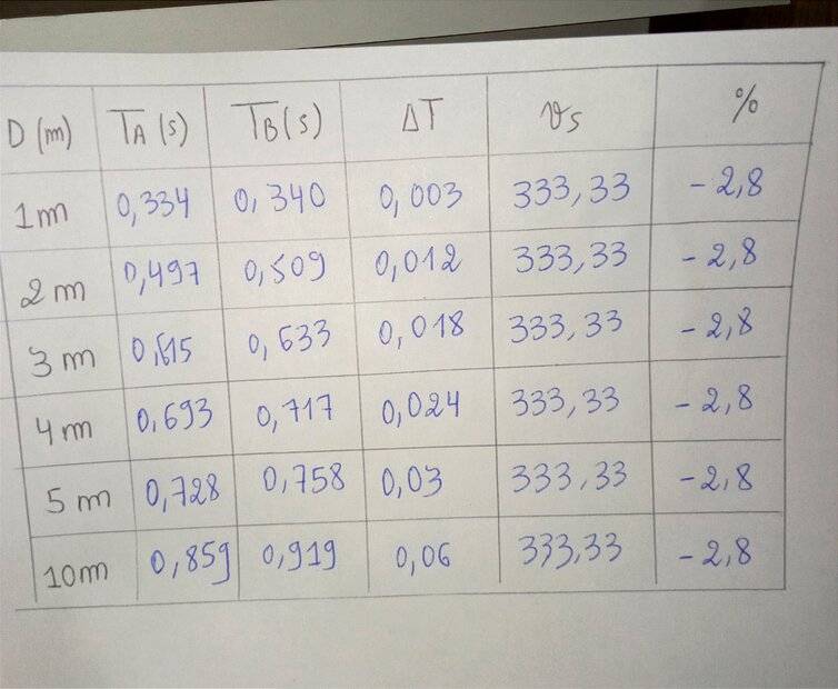

The first value in the second table is wrong. The time interval is 0.006.
The table feels like is made up. The values are too nice. Just that in the first row the author was not careful.
Oh! which one? the first table or the second one!
The second one, as I said.

Your problem, if you have followed the video exactly, may be that the source of sound is not right at the first phone, but some short distance, y, above it. The difference in the recorded times will be in proportion to the difference in the two travel distances.
If the (horizontal) distance between the phones is x then the two travel distances are ##y, \sqrt{x^2+y^2}##, making the difference ##\sqrt{x^2+y^2}-y##.
See if using that instead of x gives more consistent results. Certainly it should produce lower speeds for the shorter x values.

You don't seem to have understood my post. As others have posted, the speed of sound certainly does not vary with distance.
I am saying that the distances you used in the first table are wrong if they are the distances between the phones. The sound is not going from one phone to the other; it is going from the clapped hands to both phones.
You need to figure out how far it was from the clapping hands to the far phone, how far from them to the near phone, subtract the latter from the former, and use that as the distance in the table.
For example, your first distance in the table is 1m. Assuming the hands were 0.4m above the phone then the two distances the sound had to travel were 0.4m and 1.077m. The difference is 0.677m. With the time difference of 0.004s, that gives a speed of 383m/s, a much more reasonable number.
However, making that same assumption at the longer distances only makes the results there worse (slower). To make the speeds about the same for all distances the height of the hands needs to be about 1m, but that makes the speeds only around 220m/s.

You are insisting on the fact that you measured in a closed space as this being relevant.
The speed of sound depends only on the conditions of the medium. For sound in air the temperature and humidity are the main parameters that have an effect on the speed of sound.
Now, it is very unlikely that the temperature or humudity varies signifcantly over a few meters but not impossible in principle. But anyway, even if this were the case, it is not the distance that affects the speed but the variation in the conditions of the medium. Actually, indoors may be more likely to have temerature and humidity gradients if you have heaters or (de)humidifiers.
But I doubt that these effects can explain the large variation that you observed. For example, you need to go to about -100 Celsius to decerase the speed to about 260 m/s. The first table cannot be explained by variations in the conditions of the medium, no matter if you did the experiment indoors or outdoors.
It's more likely something to do with the experimetal setup, as sugested by @haruspex.

Just to cover the bases, what about wind? Since the experiment adds the times for the two directions, the net effect of a wind speed of v parallel to those directions would be to cut the measured speed from c to ##c-\frac{v^2}c##. Even with a wind speed of 72km/h, that's a reduction of less than 1.2m/s.
