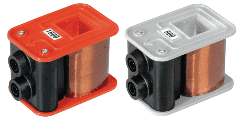

I'm doing a simple RL Circuit Lab where students use 800- and 1600-turn air core coils to measure the time constant. Experimental results very nicely agree with predicted results.
However, when students insert a steel (or iron) core in the coils, experimental results are far different than predictions.

I've included an image of the coil and core we use below. For our RL lab, we simply use one coil, not the two as shown. Using a single 800-turn coil with the pictured closed loop core increases the inductance from about 10mH to 70mH. Not exactly sure what you're suggesting--basically shimming remaining air gaps with additional high permeability material?? Again, our results with no core whatsoever are great; with a core, whether a single bar (removed from the loop), or the entire closed loop--not even close.

No, make an air gap between the core halves (assuming there was none originally); a part of the path the magnetic flux must travel that doesn't go through the high permeability core material. This makes the total permeability of the structure more stable. You will, of course, get less inductance than with no gap, but it will be harder to saturate the core and the assembly will be less sensitive to "accidental" air gaps. The material you put in the gap between the core haves can be anything non-magnetic, like post-it notes for example.

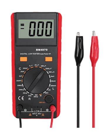

The frequency of measurement used by the LCR meter will become more important in the presence of a magnetic core. What frequency is used for the inductance measurements? What is the make and model of the LCR meter?

Thanks for your continued help! I'm traveling and have limited connectivity opportunities, hence the gaps between my responses. Here's the LCR meter we use:
"Proster LCR Meter Capacitance Inductance Resistance Tester Multimeter Self-discharge with Overrange Display"
