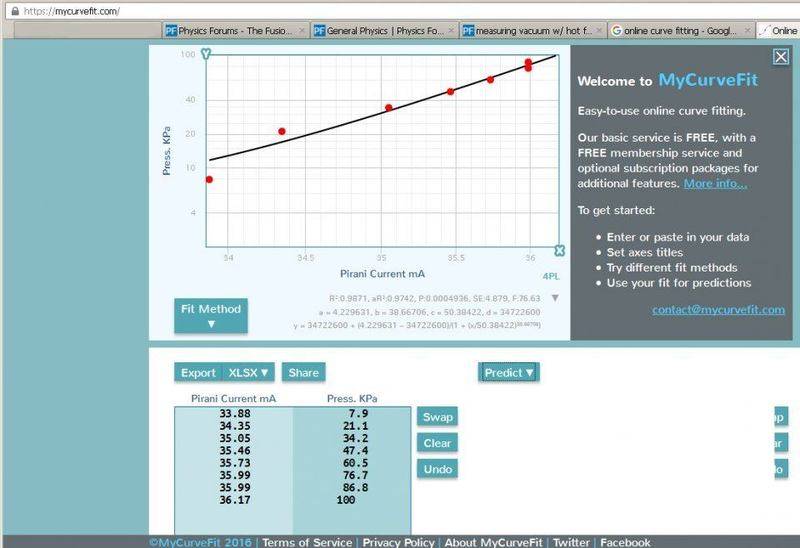

Thanks for responding, Actually this is completely homebrew, I am using a lightbulb filament that I have mounted inside the vacuum chamber. I was hoping for a way to extrapolate with the current draw known at STP for example, to any lower pressure. Assuming we are below pressures where convection plays a part, would the thermal energy loss due to conduction to surrounding gas be proportional to the density of that gas?
Just calibrate it yourself. Measure the current at a variety of known pressures and construct a calibration curve.
I tried doing this as well. I tried using boiling propylene glycol at known temperature to produce a known vapor pressure in the 5-50 Pa range, but I could not get it to boil consistently. I figured this was because of the pressure from he weight of the liquid in a container being too great for the vapor pressure to overcome.I then tried saturating a sponge in propylene glycol and inserting a thermometer into the sponge. This cools in the vacuum to a minimum of 11*C, which corresponds to a pressure of 3.4Pa. I find this suspicious because the pump is rated to 5Pa and I know the system isn't perfectly sealed. Do you think this is a valid result?
Note that you have some bad data at 76 & 86 kPa, the current is the same.
Here is the fitted equation for your data:
y = 34722600 + (4.229631 - 34722600)/(1 + (x/50.38422)^38.66706)
x = Pirani Current mAmp
y = Pressure KPa
Note that the "Y" axis is logarithmic in the graph.
Thanks so much, that's just what I needed. I can also add more data points to improve the accuracy. To my question above, when the temperature of the ethylene glycol drops as the pressure is reduced, this is because it is boiling and the pressure in the chamber will be equal to the vapor pressure of ethylene glycol at the particular temperature, correct?

I added the data points for the region below 20Pa and there seems to be a huge change in the graph somewhere between 20Pa and 7.9kPa. At or above 7.9kPa pressure changes very quickly with current draw, and at 20Pa and below, it changes very, very slowly. I'm guessing the transition between cooling largely by conduction and radiation occurs in that gap.
OK, I'll speculate. How does the mean free path of the gas compare with the sensor size around 20Pa to 7.9kPa?
I suspect the mean free path becomes longer than the filament diameter in the range. I hadn't considered that affect. But I think it is still useful for a sensor because the graph has a one-to-one correlation everywhere.
Looks like 1.2E-6 meters at 7.9kPa and 4.7E-4 meters or 0.47mm at 20 Pa. That is certainly larger than the filament diameter.

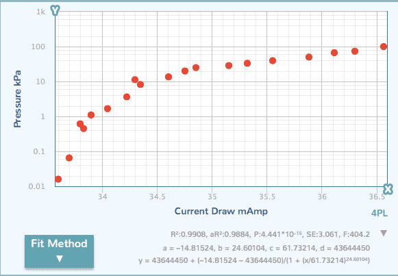

This is what I came up with. When I mentioned earlier the sudden change between 20Pa and 7.9kPa, that looks to be due to a mismatch in data between using the sponge and not. For this data, I used the rough vacuum gauge, boiling ethylene glycol, water, and 70% by volume isopropyl alcohol (conscious of fire hazard). For the alcohol, I calculated the vapor pressure of the mixture using the mole fraction and Raoult's law(although I know there is some error as this deviates from an ideal mixture). The different substances seem to agree pretty well, but the reading for the alcohol seemed to result at slightly lower pressure vs current draw. Maybe this is due to a difference in thermal conductivity as a gas? Anyway, I decided to leave in data points that seem contradictory (water vs alcohol), thinking the function would be more accurate with all of them considered.
On second thought, I should remove the alcohol data points, I think there is too much error due to this not being an ideal mixture.
Likes Tom.G
Inadvertently, I have found another interesting thing about gas at low pressure. There looks to be a specific pressure below which thermal conductivity of air decreases suddenly and dramatically. In the chamber, I was running a small fan with a piece of tissue paper taped to the front, so I could observe the movement of the tissue from airflow at various pressures. The moving air from the fan was also cooling the filament and increasing the current draw substantially. This affect is almost constant above about 3kPa, and decreases to zero very quickly thereafter as pressure continues to drop.
I have also finalized the graph, it looks very similar to the one posted above, except that the conflicting points from the isopropyl alcohol have been removed. Turns out, they seemed out of place because the alcohol was boiling at a higher pressure than I had calculated it should, due to the mixture not being close to an ideal one.
