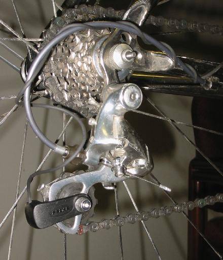

There was actually a chain tension power meter invented and in production mid 1990s to about mid 2000s. Invented by the Cote brothers and sold by polar. It sensed chain tension acoustically like a guitar pickup, a chain speed sensor pulley on the back. I will show pictures below.
They have built power meters just about everywhere you can put them. Pedal, sole of shoe, cleat between pedal and shoe, crank, spider, chain, rear wheel hub, and a power meter that calculates power by measuring resistive forces http://www.ibikesports.com/index.php/product/how-the-ibike-works/ . I think one of the most interesting is the laser spoke power meter http://bicycledesign.net/2012/05/laser-spoke-power-meter/. It use the whole rear wheel as a strain gauge. What is really interesting is that it can tell when your rear wheel is getting worn out. The whole concept open up other possibilities of making power meter between components and being able to tell when a part is wearing out. They are now making bikes with electronic shifters to shift the chain and that opens possibilities because now a computer knows what gears you are in, the speed of the bike, RPMs, it does take much more to make a power meter.
I am just an end user bicyclist and long time user of power meters but part of what I like about bicycling is all the physics, math, and married to physiology. I just keep on learning.
"The main sensor unit houses two sensors: a cadence and a chain tension sensor. An LED next to the Polar logo flashes red and green(initially) to confirm that a signal is being received by the speed and cadence sensor, respectively. Yes, the cadence magnet is mounted on the right crank. The speed sensor is mounted on the left chainstay (partially hidden here). A third wire (seen here) going to the chain speed sensor mounted on the lower derailleur pulley."
Picture and text pulled from this website: http://www.u.arizona.edu/~sandiway/bike/s710/

From the picture posted in the other thread (just look at the list of Mark's post, there are not many), it appears that the device measures the strain between the front axis that carries the pedals, and the chain ring(s). If I had to implement that I would use one, maybe 2 strain gauges that could be sampled continuously. This is cleaner (encapsulated) and easier to implement than a chain tension sensor, and it is probably also more accurate.
Having said that I only know the pictures from the other thread. I have never seen the device in real life, let alone opened it and looked inside.
I am not sure if the additional sensors you propose would help in better measuring the power developed by the cyclist - which is the ultimate purpose of the whole thing.
BTW, data rate should not be a problem because the first sampling and averaging could easily be done in the device, and only the statistics and averages communicated to the host device. On the other hand, using a smart phone and bluetooth as the host controller there are basically no limits on the data rate.

There is a Powertap power meter http://www.powertap.com/ that measure power from the rear hub. It use a torque tube to measure force.
Having a computer know what gear your in will be easier in the future as more electronic shifting becomes use and hopefully tracks the shifting.
