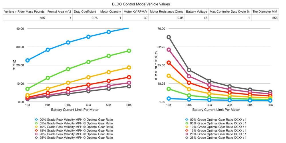

According to my calulations (& I'd be happy to share the formulas), on a 10 % slope with 655 ##lbs## total vehicle mass (297 ##kg##), a 1 ##meter## frontal area, 0.75 drag coefficient, 9.80 ##m/s^2## gravity on earth, 1.23 ##kg/m^3## fluid density of air, (1) 30 ##kv## motor, with 0.05 ##ohm## resistance, 30 ##amp## battery current limit, 48 ##volt## battery voltage and 558 ##mm## diameter tires, the max possible velocity up slope is 10.4 ##mph## ( 4.65 ##m/s## ) assuming the optimal 8.76:1 turns motor:wheel gear ratio is used. If a different KV motor is chosen a different gear ratio will be necessary to achieve the max possible velocity. If the resistance is higher the top speed will be slightly lower (assuming optimal gear ratio is used) due to the increased copper losses. This assumes your drive wheel doesn't slip on the terrain.

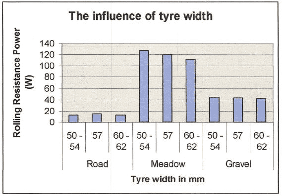

Given that the motor is 1000 watts you are pushing that bike a little too hard. On hard surface roads and at lower speeds bicycles are very efficient but once you get on rugged terrain or soft dirt roads efficiency goes way down. I know that biking on soft rails to trails bicycle paths really sucks your energy away. Best to bike on those trails when hard.
I Believe the above is rolling resistance for normal mountain bike plus rider, in the above case for roughly triple the weight you would roughly triple the numbers in the graph above?

##48v * 30a = 1440w## electrical power
##30a^2 * 0.05ohm = 45w## copper loss
##1440w - 45w = 1395w## peak mechanical power available...
then one has to factor the assumed ##1m^2## frontal area and ##0.75## coefficient of drag...
