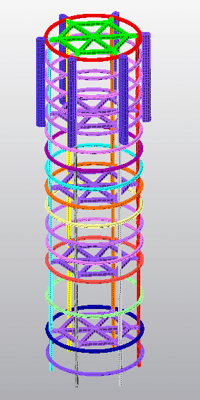

Dear all,
I made a cad of floating structure (the frame only), figure attached below. It should be located in the water and moored, so it can't go anywhere. The CFD simulation was done. So I have fluid force on the structure. Now I want to do mechanical analysis of the structure by apply the fluid force as external load. I have no problem in operating the software. My problem is, I already try some scenarios of boundary condition of the structure, such as fixed, pin, etc., and I found that the deformation isn't as expected (large bending) or no displacement at all.
Any idea?
Regards,
Shade

What is the nature of the unexpected deformations or displacements? Are you constraining the structure by its floats? As a general rule you will want to constrain the model such that expansion/contraction can occur but rigid body motion cannot.

Thank you. I want to constraint it by its mooring position. So probably there won't be any frame displacement, but I expect there's stress distribution.
So, I'm still try any combination of constraints at different part of the structure.

Without a better description with pictures of the problem you're seeing, I'm not sure we can help you any more effectively.
