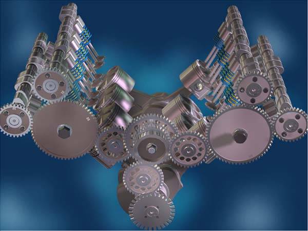

If cost and noise are not considerations, then a total gear train can be used for cam drives, a la the old Cosworth V-8 F1 engines:
that is fascinating, I have never seen anything like that. Thanks for sharing!
so then the real considerations are regarding the space limitations, and the ease of repair if I read that correctly. If that were not the case, then is gear on gear a better set up than a chain? just in general, isn't a gear on a gear going to be much more stable over long periods than chain on a gear? What I am considering is the fact that there is less slack in a gear/gear system than a gear/chain system. of course this isn't doesn't seem like such a big issue if the system doesn't experience high torque. aside from the obvious space limitation preventing it from using a chain, I could see this being a reason for starters to contact the flywheel gear directly. Am I even close in my reasoning here?

All mechanical design is a series of tradeoffs. Cost, ease of construction, and ease of repair figure into every design. Sure, gears are probably less prone to developing slack than a chain or a belt, but they are also more expensive to make. However, gears are also prone to losing teeth, and this could disrupt valve timing.
In your motorcycle engine, the small package of the engine means that small gears must be used, and small gears can only transmit so much torque and still have a long service life. The central location of the cam drives make it difficult to install a series of gears without having a two piece block or two banks of cylinders, all of which adds to the cost of manufacture and maintenance.
The F1 Cosworth engine in the picture is a handmade unit which probably sold for more than $50,000 when new. Racing engines run only a few races before they are scrapped, and in between races, they are torn down, inspected, and re-built. Using a lot of gears is OK because of the amount of inspection and maintenance these engines receive. For everyday use, this would be unacceptable in terms of high cost and inconvenience.

That is not the case if you use a train of more than two gears. You would probably need more than two gears to span the distance between the crank and the cam, unless the gears were unfeasibly large. See the Cosworth V8 picture.
AlephZero. You are correct. An idler gear is analogous to a belt or chain.
But then the idler gears in a train should not have common factors with their immediate contacts.
