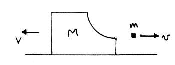

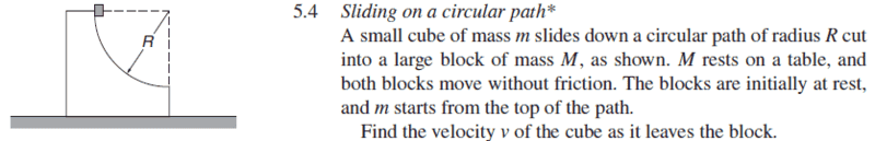

( The following problem is taken from kleppner's " Introduction to mechanics" )
( The question in the book talks about the velocity but my confusion is related to the Energy )
Conservation of Mechanical energy : Ef - Ei = 0
Consevation of Momentum : Pf - Pi = 0
If I can assume the time which mass 'm' reaches the edge of the block is very small , and if I also assume both masses ( m , M ) are pretty small , then the total impulse can be approximately zero and the total momentum difference is conserved , so that :
where ' V ' is the velocity of the larger object 'M'
and ' v ' is the velocity of the smaller object 'm'
So far all is correct.

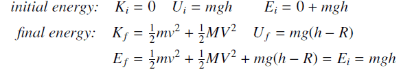

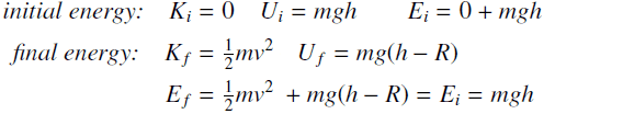

Afterwards , I used the total conservation of mechanical energy : Ef - Ei = 0
and only used it for mass 'm' ( the normal force does no work since it's constantly prependicular to the
cube's path and the only work done on mass 'm' is from gravity ) so that :
Eventually getting ( my answer ) :
However , this is not the correct answer , because in the answers they included both the energies by mass 'm' and mass 'M' , so that:
Eventually getting ( the correct answer ) :
So my question is : why I can't use the total consevation of mechanical energy for only mass 'm' like I did , why's it not correct? ( gravitational potential energy is included , kinetic energy is included and normal force does no work ) and why do I have to add the energies of the bigger mass ' M ' ?
cube's path
I think the problem lies here . Isn't large block of mass M also moving :smile:?
Yes, but why do I have to add it's energy? , after all , it seems that there doesn't exist some force on mass 'm1' which does work to be added into the conservation of mechanical energy of mass 'm' , in order to correct the equation:
CGandC said:
Yes, but why do I have to add it's energy? , after all , it seems that there doesn't exist some force on mass 'm1' which does work to be added into the conservation of mechanical energy of mass 'm' , in order to correct the equation: View attachment 211579
You are incorrectly assuming that work done by normal force on small cube is zero. It isn't .
Why not? , it is perpendicular to the small cube's path .
It seems to me that you are neglecting conservation of momentum, which means your calculation of final energy is missing the kinetic energy of the large block.
The path of the small cube is circular when seen from the moving frame of block M .It's path as seen from the ground frame is not circular .
Vc = Vc,M + VM
The first term on right side is the relative velocity of cube w.r.t M . It is this component which is perpendicular to normal force . But the dot product of second component with N is not zero .
Negative work is done by normal force on small cube as it slides along the circular arc :smile:
Yes , it does miss the kinetic energy of the large block but I still don't fully understand why do I need to add it, can't I just use the energies of the small cube?
and the conservation of momentum is conserved which is why I get :
and the conservation of momentum is conserved which is why I get : View attachment 211604
Okay, so this implies:
##mv=MV\implies V=\dfrac{mv}{M}##
And so, by conservation of energy, we have:
##\Delta E=E_i-E_f=mgR-\dfrac{1}{2}\left(mv^2+MV^2\right)=0##
or:
##2mgR=mv^2+MV^2##
Using the implication from conservation of momentum, we obtain:
##2mgR=mv^2+M\left(\dfrac{mv}{M}\right)^2##
Solve for ##v##...what do you get?
As conscience pointed out in post #7, the path of the small cube, seen in a rest frame, is not an arc of a circle. Its motion does have a component in the direction of the normal force. So it is not obvious what the energy of the small cube is.
Then suppose I'm at the frame of the moving block M , so that the path the small cube does is circular.
Then the normal force does no work and why do I still need to add the energies of the large block of mass 'M' ( to the energies of the small cube ) ?
You cannot apply Work Energy theorem from a non inertial frame .Since block M is accelerating , energy conservation doesn't hold true .
As seen from block M , ##mgR ≠ \frac{1}{2}mv^2## , where v is relative speed of cube with respect to M as it meaves M .
