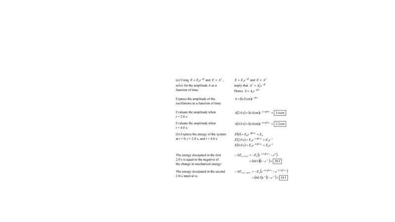

A = A(initial) * e-(t/time constant)
E = E(initial) * e-(t/time constant)
I followed the method of the attached picture and couldn't get the correct answer.
Part 1: Answered correctly:
A(8.7 s) = (1.3 cm) * e-(8.7/8.8) = 0.4837088518 cm
Part 2:
Change in mechanical energy between 0 and 7.8 seconds:
ΔE = -E(initial) * (e-(8.7/8.8) - e-(0/8.8))
ΔE = -(36 J) * (e-(8.7/8.8) - 1)
ΔE = 22.604985 J
Which was incorrect
Part 3:
ΔE = -(36 J) * (e-(17.4/8.8) - e-(8.7/8.8))
ΔE = 8.4109474 J
Which was also incorrect.
Check the small print (I can hadly read it): Energy is proportional to A2, so one of your equations isn't right
