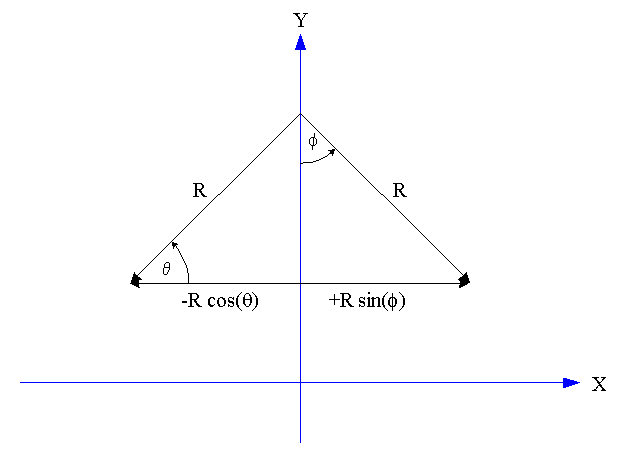

One more to ask, to find the x-component which using cos theta, we use the theta as the value from positive x-axis right?
It depends on the orientation of triangle you're looking at. It's best to sketch in the angle you're going to use and determine its value from whatever reference direction is convenient. Assign the sign to the component by verifying its direction on your sketch.
Sometimes you're given a different angle to work with, such as the angle with respect to the vertical (y-axis), in which case you would use the sine of the angle in calculating the x-component!
