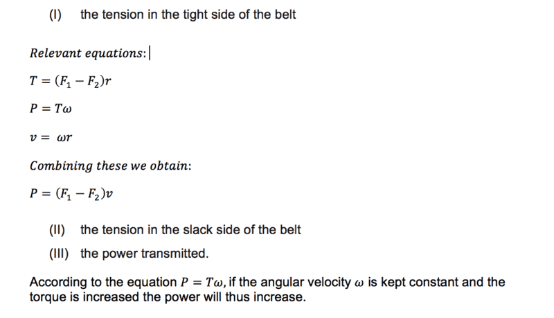

Question One
What would be the effect on the following if the load torque is increased and the speed maintains constant (give reasons for your answer):
A. the tension in the tight side of the belt
B. the tension in the slack side of the belt
C. the power transmitted.
Not sure on how to solve for F1 and F2. Any ideas are appreciated.
I assume the equations we will require are,
P = (F1-F2)v,
T = (F1-F2)r
P = Tw
v = wr
According to the equation https://www.physicsforums.com/cid:clip_image001.pngif the angular velocity https://www.physicsforums.com/cid:clip_image002.png is kept constant and the torque is increased the power will thus increase.

Sorry for the template issues, I've been having some trouble creating the thread. The main body of information was provided for the question below

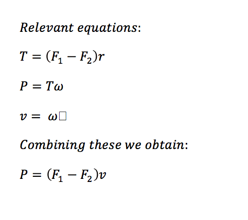

A pulley 150 mm diameter is driven directly by an electric motor at 250 revs min–1. A V-belt is used to transmit power from this pulley to a second pulley 400 mm diameter against a load of 200 Nm.
The distance between the centre of the pulleys is 600 mm, the included angle of the pulley groove = 40°, the coefficient of friction between the belt and pulley is 0.4 and the ultimate strength of the belt is 8 kN.
I've done the below if that helps.
Take a look at your first relevant equation. If R is constant and T changes what is the implication for F1-F2?
