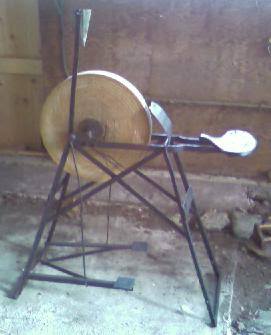

Look at the picture below. It is a picture of a foot-powered grinding wheel. The wheel serves as the "flywheel", smoothing out the impulses from a foot pushing down on the "treadle" pedal (this particular wheel has two treadles, but you can also do this with one treadle). You would adapt the concept to your preferred geometry, and connect a generator to the flywheel to do the mechanical-to-electrical conversion.
http://1.bp.blogspot.com/_32vVyg8Qnag/S230cmO363I/AAAAAAAAALU/NLpxGRYr944/s400/grinding-wheel.JPG
