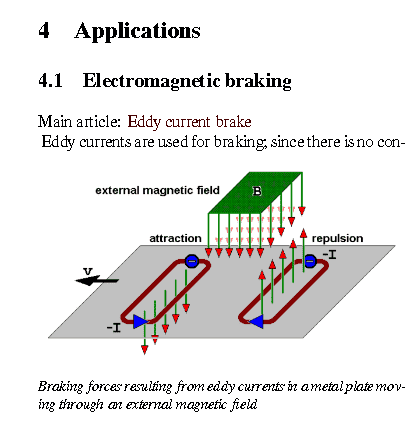

I held my strong fridge magnet close to the fridge and waved it back and forth. Couldn't feel any difference in attractive force.
In a magnetic brake drag at higher relative speed will be greater.
https://www.princeton.edu/ssp/joseph-henry-project/eddy-currents/eddy_wiki.pdf
Eddy current loss goes up with frequency.
In a generator the field strength would be reduced as speed increases so as to keep terminal volts within reason, countering the braking force from eddy currents..
Generators are laminated so as to minimize eddy current loss and thickness of the laminations determines to what frequency are they effective.. So which effect wins out, increased frequency or reduced field, depends on how the machine is built and operated.
