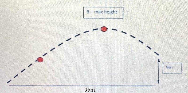

A ball has travelled a horizontal distance of 95m and landed 9m up in a stand as shown in the diagram attached below. The time of the flight was 4.5s. Calculate the angle at which the ball was hit.
##\theta=\arctan(\frac{v_{y}}{v_{x}})##
##v^2_y = v^2_{0y} - 2 g(y-y_0)##
##v## indicates velocity and ##y## is height.
I am trying to find the launch angle ##\theta## using the relationship:
So, ignoring attenuation due to air resistance, we have a constant horizontal velocity:
##v_x = d_x/t = 95m/4.5s \approx 21 m/s##
But what value do we use for ##v_y## which is not constant? It has a positive value until the ball reaches the apex of the trajectory where ##v_y=0##. Or is there a simpler way to approach this problem?
Any help is greatly appreciated.

roam said:
Byut what value do we use for ##v_y## which is not constant? It has a positive value until the ball reaches the apex of the trajectory where ##v_y=0##. Or is there a simpler way to approach this problem?
You are on the right track.
Let ##v_y## be the vertical component of the initial velocity, i.e. at the moment of launch.
The vertical motion is independent of the horizontal motion. In the vertical direction, the start position is (say) ##y_0 = 0## and the final position is ##y=10m## (taking upwards as positive).
[Edit: sorry, that should be ##y=9m##.]
You are given the time of flight (t) and the vertical acceleration (a=g).
Do you know any (standard) equation relating ##y, y_0, v_y## (initial velocity), ##a## and ##t##? (Hint: it’s a quadratic equation as there are two times at which the height is 10m.)
[Edit: sorry, that should be 9m.]

roam said:
Hi there,
I'm not sure, do you mean ##v^2_y = v_{0y}^2 -2a(y-y_0)##?
In that case, we have ##v^2_y = v_{0y}^2 -2 (9.81) \times 9##. That is as far as we could go with this equation.
P.S. The final height of the projectile is 9m.
You don't know the vertical component of the final velocity, so that equation isn't very useful.
You do know the final height and time of flight. Can you get the vertical component of the initial velocity from that using a different equation?
Likes roam and Steve4Physics
roam said:
The problem is that they didn't give us a single initial launch velocity from which we could calculate ##x## and ##y## components.
If you were given the initial velocity it would a) be too easy and b) you wouldn't need to know the final height of ##9m##. It's not a good idea to worry about what you are not given in such problems - instead, you should focus on what you are given!

rudransh verma said:
@PeroK how is the final height=9. I think the final height would be the max distance the ball traveled up to where the velocity becomes zero. This height is not given.
The final height is ##9m##. I'm not sure why anyone would look at that diagram and conclude otherwise.
If a ball lands on ground what will be the final height?
I say this because the vertical velocity component is positive then zero then negative in its total journey. So I guess we should be taking the component up to where it’s direction stays same.
  • Skeptical
Likes davenn and PeroK
It does not land on the ground...
roam said:
Homework Statement:: A ball has traveled a horizontal distance of 95m and landed 9m up in a stand
When ##v_y = 0##, the ball is still midflight. Why do you think ##y## at this point is its final height?

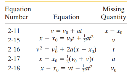

Hi @roam. My apologies - in Post #2 I took final height y=10m, but of course it is y=9m.
There is a set of standard 'kinematics equations' used in problems where motion is in 1-dimension and acceleration is constant. There are 4 (or 5 depending on where you are taught) equations.
For motion with constant acceleration in, say, the x-direction, the 5 equations are shown here:
https://www.physicsforums.com/attachments/qepqu-png.155340/
The symbols used in the image are:
##v_0## = the initial velocity
##v## = the final velocity
##x_0## = the initial position (x-coordinate)
##x## = the final position (x-coordinate)
##a## = the constant acceleration (in the x-direction)
##t## = the elapsed time between initial and final states
Of course you can change 'x' to 'y' if considering motion in the y-direction.
There are slight variations in the format and symbols used. (Sometimes the symbols s, u, v, a and t are used and the equations are then referred to as the 'suvat' equations.) I hope you recognise these equations,
Can you see how to use one of the equations to find the initial y-component of velocity?
Remember for a projectile in free-fall, the vertical component of motion is unaffected by the horizontal component of motion.
Likes roam

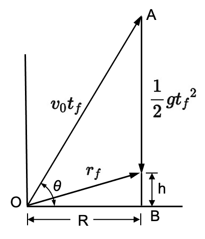

The solution to this problem is greatly simplified if one considers the final position of the projectile as the sum of two vectors, one along the initial velocity and one along the acceleration of gravity:$$\vec r_{\!f}=\vec v_0 ~t_{\!f}+\frac{1}{2}\vec g~ t_{\!f}^2.$$The drawing below shows the vector addition. Finding the angle of projection using simple trigonometry on right triangle OAB is trivial when the time of flight ##t_{\!f}##, horizontal range ##R## and landing height ##h## are known.
Likes roam, vela, PAllen and 1 other person
Being careful not to extend the observations beyond introductory levels, but that is potentially a general relativistic approach, where there is no force of gravity, but the ground is accelerating upwards!
The projectile travels inertially in a straight line at constant velocity, while the target starts at height ##h## and accelerates upwards at ##g##.
Likes roam
Sure, but I was thinking more along the lines of assembling the two relevant kinematic equations into a single vector equation and representing that graphically. No GR here.
That's true, but it does highlight how the nature of gravity as a ficticious force lurks in introductory projectile kinematics!
Or using your vector equation ##\vec{v} \times \vec{u} = \vec{g} \times \vec{R}##:
Solve for y: {190/9,-sqrt(y^2-2*9.81*9)} cross {190,y} ={0,-9.81} cross {95,0}
Doesn't even need the 't' value but I guess not really appropriate for this homework question.
Edit: this is wrong - we needed the t-value to calculate ## v_x=190/9 \approx 21.11\;ms^{-1} ##

##9-0=v_{y}(4.5)+\frac{1}{2}(-9.81)(4.5)^{2}##
##\therefore v_{y}\approx\ 24 \text{m/s.}##
Is it possible to use this same value to work out the maximum height ##h## of the projectile (at point B of the diagram)?
I mean, there is another kinematic equation that could be used (given that the vertical velocity at the apex is 0):
##v_{y(\text{final})}^{2}=v_{y(\text{initial})}^{2}+2ah##
##0=24^{2}+2(-9.8)h \implies h \approx 29\ \text{m}##
So, was our previously calculated value for ##v_{y}## appropriate to be substituted as ##v_{y(\text{initial})}## in the second equation for finding ##h##?

Yes, but finding one numerical value then plugging that into a formula to find another can lead to accumulation of errors. Keep a digit or two of extra precision in the first calculation.
Alternatively, it is often better to keep the first result in algebraic form and continue that way to the second result, only plugging in numbers at the final step. That might be awkward here, though.

Of course. Vy will not change. It’s same for all instants in this situation.

Conservation of mechanical energy: $$mgh_{max}=½m{v_{yi}}^2$$

You can invent your own equation in terms of the given quantities. Knowing the time of flight makes the task easy. You know that the maximum height occurs at half the time of flight and that the vertical velocity is zero when that happens. Then you can write two equations expressing these ideas:
$$h_{\text{max}}=v_{\text{0y}}\frac{t_{\!f}}{2}-\frac{1}{2}g\left(\frac{t_{\!f}}{2}\right)^2~;~~0=v_{\text{0y}}^2-2gh_{\text{max}}.$$The task before you is to use the second equation to substitute ##v_{\text{0y}}## into the first equation and solve the ensuing quadratic.
On edit: This is bad advice. See post #36.

If you know that it was at height ##y = 9m## at time ##t = 4.5s##, then you have:
$$y = v_{0y}t - \frac 1 2 g t^2 \ \Rightarrow \ v_{0y} = \frac 1 {t}(y + \frac 1 2 g t^2)$$And, the maximum height ##h## is given by the equation $$2gh = v_{0y}^2 \ \Rightarrow \ h = \frac{v_{0y}^2}{2g}$$ And, as mentioned above, you can either combine those equations or solve for ##v_{0y}## first.
You do need to be careful if ##t_f## is not when it returns to the ground.
