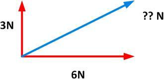

1. Homework Statement
A particle of mass 0.30 kg moves with an angular velocity of 10 rad s^1 in a horizontal circle 20 cm inside a smooth hemispherical bowl. FInd the reaction of the bowl on the particle and the radius of the bowl.
Answer: 6.7 N, 22 cm

I am a bit lost because in this link with a wrong (according to the book the answer is 6.7 N) 6 N answer Thanuka got 22.3 cm, a relatively correct answer... And how to get the 6.7 N answer as in the book?

The 6N at that link is for the centripetal force, which is only the horizontal component of the reaction. The 6.7 N is the entire reaction.

Thank you. But in that case horizontal F = m(w^2)*r = 0.3 kg * 10^2 rads^-1 * 0.2 m = 6 N. And vertical F = mg = 0.3 kg * 10 (simplified g) = 3 N. In that case 6 N + 3 N = 9 N and not 6.7 N. Could you elaborate a bit on how to get 6.7 N? The bowl is smooth so I consider the only vertical force is gravity (F=mg).

This give you an idea ?
Did you make your own drawing already (to see what's this sine and cosine business) ?

I actually made a same drawing though instead of 3 N and 6 N I had R cos angle and R sin angle. Now I get the second part: cos angle = 6 N / R -> R cos angle = 6 N and sin angle = 3 N / R -> R sin angle = 3 N.
But I still don't quite understand how to get the 6.7 N answer from the book for the first part.
Try finding how much ?? is ...

R = 3 / sin angle
R = 6 / cos angle
3/sin angle = 6/cos angle
3 cos angle = 6 sin angle
cos angle = 2 sin angle
Are you telling me you have difficulty calculating the hypothenuse of a triangle with short sides 6 and 3 ?
Likes moenste
3^2+6^2 = 45, root 45 = 6.7 N... I really was looking for something complicated and totally forgot the basics. Thanks a lot!
