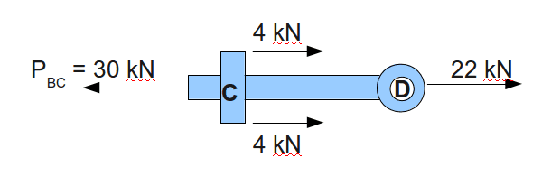

I was reading through my mechanics of materials book (Mechanics of Materials 8th ed. R.C. Hibbler) learning about stress and came across example 1.6 pg. 28. while most of the example makes sense the last bit of part b) confused me. I am unsure as to why for Pcd he only showed the 22 kN force acting in both directions but neglected the two 4 kN forces acting in the positive x direction..

For the bar to be in equilibrium and not accelerating, the forces in all directions must be equal. For this example, there are only forces in one direction which I will call the x-direction with negative to the left and positive to the right (adherence to standard protocol). What are the forces in the negative x-direction? (12+9+9)kN = 30 kN. What about in the positive x-direction? (4+4+22)kN = 30 kN. Summing the forces in the x-direction:
[tex]\Sigma[/tex]=-30 kN + 30 kN = 0 kN.
So, the forces are equal in all directions which means that there is no acceleration.
Now, look at each load point. -12 kN at point A. -18 kN at point B. +8 kN at point C. +22 kN at point D. Hibbeler shows you the loads and resultant forces on each section in figure 1-16 b. For example, the -12 kN load at point A must be counteracted by +12 kN on the other side of point A (Newton's third law of motion). If we keep moving along the bar to the right (positive x-direction) we encounter two -9 kN forces at point B. So what happens to the right of point B? Well, there must be a force counteracting the forces at A and B for a total of 30 kN (again, Newton's third law). If we keeping moving to the right nothing happens until we get to the next load at point C.
So, what's going on between point B and C? Well, we know that at point B there are a total of 30 kN acting in the negative x-direction. We also have to assume that there are 30 kN acting in the positive x-direction to counteract the load and keep the bar from accelerating (equilibrium).
Wrapping this all up, Hibbeler assumes you realize that to the left of point C you'll see a 30 kN force acting in the negative x-direction. You weren't given a drawing of that because it's assumed to be obvious from your course in Statics. If he had drawn it, it would look a lot like you'd expect it to and something like the attached image.

Thank you for the detailed explanation. I figured out my mistake I wasn't putting together that the 30kN force to the left would have the two 4kN forces to the right subtracted from it giving you the 22kN I don't know how I missed that. Thanks so much for the help
