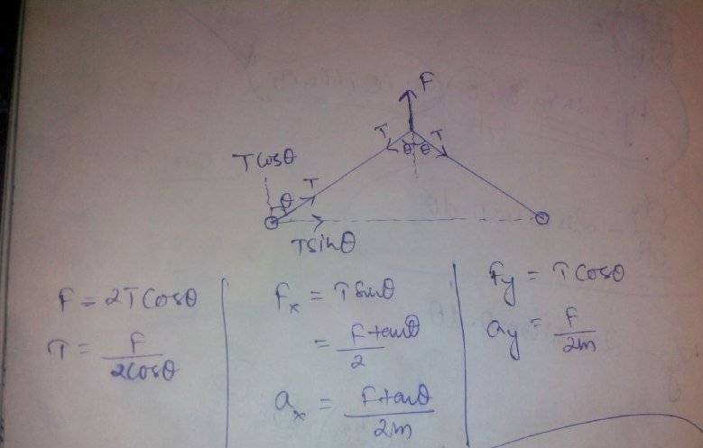

Ok. This is what I did.
I have assumed whole case at some angle θ with vertical and then resolved the force
http://filesystem:https://web.telegram.org/temporary/851516233_42736_5351388760177376947.jpg
so,
F = 2Tcosθ
T = F/(2cosθ)
Now, for an individual mass
F(x) = T sinθ = (F tanθ)/2
a(x) = (F tanθ)/2m ↔ ∫dv(x) = (F/2m) ∫tan ωt .dt [ I don't know what to do next at this point]
F(y) = T cosθ
a(y) = F/2m ↔ v(y) = Ft/2m
Perhaps I can use one more equation
x/y = tan θ
x = y tanθ
dx = y sec^2 θ. dθ
dx/dt = d/dt ( y sec^2 θ. dθ) [Again I am stuck here..what next]
Now I have equations for v(x) and v(y) but v(x) is function of θ/ω, and I don't know if angular velocity is really constant.
again if i approach it from different method time for meeting can be calculating by assuming situation for motion along x axis
l = (1/2)[{a(x) + a(y)} (t^2)]
but here answer will come in terms of θ.

What do you call x and y? What is theta? Make a sketch and show, please. The picture in the post does not show.
Ok. This is the diagram I used to make equations..
On the other hand I used some other method to solve it...
Let the point of application moves distance d before masses meet, worked done on system would be F.d
By work energy theorem
F.d = 2 (1/2 m v^2)
v^2 = Fd/m
again for motion along y-axis
a(y) = F/2m, u = 0, s = d - l/2
So using equation v^2 = u^2 + 2as
Fd/m = 2 (F/2m) (d-l/2)
well this equation is meaningless..reaches nowhere

v is the total speed, so v2=vx2+vy2 here.

Along the y axis, you have to use the y component of velocity.

Well...you see at the moment they meet, speed along x-axis will be zero and as I am taking energy concept in use I have to care only about initial and final positions. initially speed along x as well as y-axis was zero and finally speed is only along y axis.

Finally whole speed is in y-axis only, i hope.

The horizontal components of velocity becomes zero when the balls collide. During their motion the x component of acceleration is towards the middle which makes the magnitude of the horizontal velocity increase, How can it become zero, if the acceleration never changes sign?

Yes , you are right. But acceleration perpetually changes magnitude along x axis...and x component of acceleration / force will vanish ultimately. But what's the nature of acceleration and velocity along x axis..i really don't know. I feel calculus is involved here. Can you help?
Sorry, I do not think this problem is properly set. You said, correctly, that F=2T cos(θ). The problem stated that initially a finite force F acted perpendicularly at the centre of the string. At the beginning, θ=pi/2, and cos (θ)=0. That would mean infinite tension in the string. I think, you should assume some initial angle between the strings and the vertical. Have you found this problem somewhere, or was it your idea?
