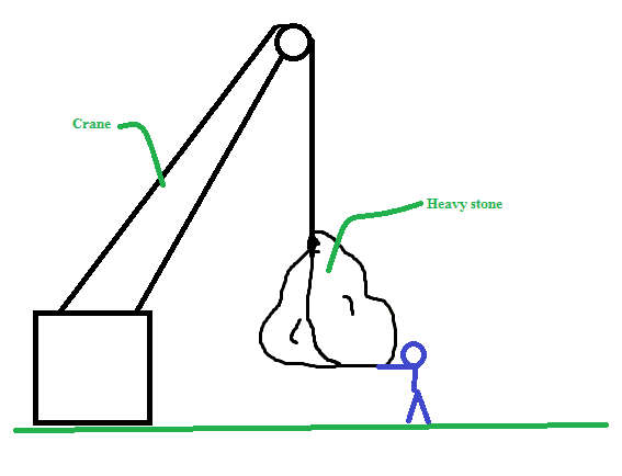

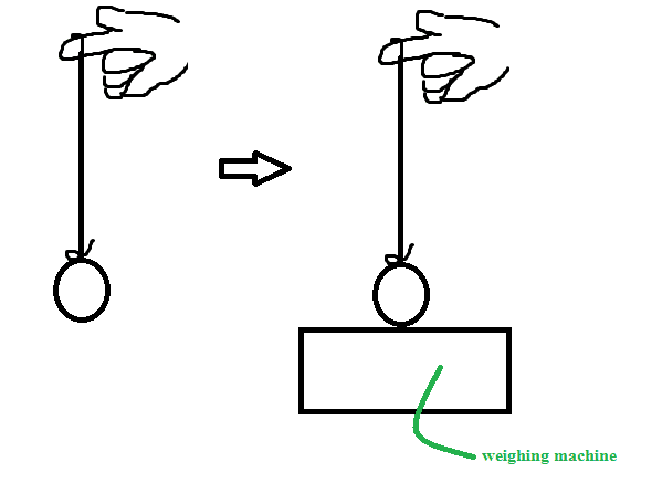

No. Suppose, you hang a ball with a rope. The rope is straight. Then you just touch the ball on a weighing machine keeping the rope straight. Will there be any weight found on the machine?
Another example. Suppose, a heavy stone hangs from a crane. And you touch your hand under the stone. Will you feel any force on your hand?
Alright, I think I understand what you mean.So would the equation for the other man just be ##R+f−mg=ma## since he is identical to the first man and the equation for platform would be ##2f -1.2mg = ma## Two f for the tensions forces acting on the block, minus the downward component of force?
