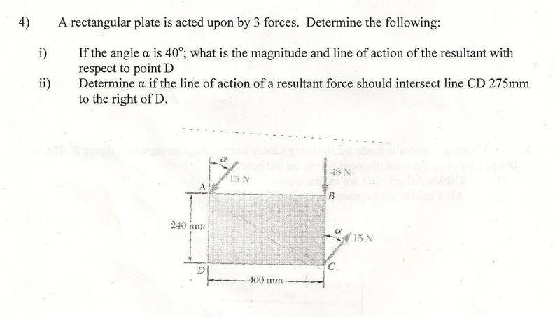

Mechanics, specifically Moment question
In summary, the conversation discusses finding the moment at a specific point (D) for a couple. The equation for calculating moment for couples is given, and there is a question about whether the resultant force and moment would be the same everywhere. A hint is given to consider the line of action when determining the moment.
SirMarksAlot
Also, I am not entirely sure what the question is exactly asking. Also, what does the line of action represent?
M = Fx(Perpendicular distance) + Fy(Perpendicular distance)
For couples:
M=Fd
i was thinking that i need to find the moment at D, but wouldn't the resultant force still be the same? except located at D? However, since this is a couple, would the moment be the same everywhere?
A force located at D doesn't give a moment (in D).
You shoud find a force located somewhere else than D.
A hint: the text speaks about LINE of action. Why ?
Wouldnt the force anywhere still be 48 N since the couple cancels each other out, and leaves only the moment?
Also, is the line of action just the direction/line that the force follows?
