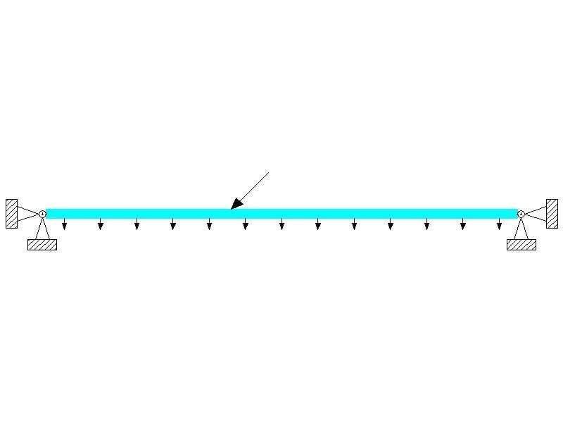

Suppose I have a beam and I would like to constrain it (two dimensional structure). At one end I've chosen to use support which constrains motion only in "x" and "y" direction (horizontally and vertically), but it doesn't prevent a body from rotation. Because of that, another beam's end have to be constrained as well. If I use the same type of support, the system would have four unknown and three equations. Is it still possible to solve this kind of system and how should I proceed with it? Would it be correct to split the problem in two cases and solve them separately, choosing the unknown resultants depending on the loading conditions?

You are right, I forgot to mention what kind of load beam has. Okay, in my case there are two forces to consider. The first is a weight and the second is a force directed downwards at some angle "alpha" (basically it has horizontal and vertical component). And there is another issue here: the resultants of the support reacts only in one direction, like with the wall or the floor.
This is a possible interpretation of what @anton_kiziloff describes .
Not sure what was meant by 'a weight' .
As for : ' the resultants of the support reacts only in one direction, like with the wall or the floor '. I don't think that requirement can be met entirely without modifying the loads and/or the constraints .
Why not tell us what you are actually trying to do ?
There are standard methods for analysing statically indeterminate beam problems .

Thank you @Nidum for the picture you've provided. This is an almost perfect graphical description of the system I've had in mind. As for the thing I was trying to achieve, it is quit simple. I was trying to apply the knowledge from the statical mechanics to the real life situations. For example, if one had some body under the load and he would like to restrain its motion, how would he do that? What needs to be considered? Where to start and how to move next? I mean, in the textbooks we have already prepared examples with the described forces and connections. But what if only body is provided with the forces acting on it, and nothing more? How to choose the right connection/support?!
Returning to the main topic here, there is something else worth trying... How about using the third Newton law? If there is no action, then there is no reaction. So in the case of reaction acting only in one direction, it should work. Like in the @Nidum figure. Each of beam's end has an upwards directed vertical component of a resultant and a horizontal component directed opposite to support. But there are no components in other directions. So what matters here is the angle of the force acting on beam. Just thinking logically, when the angle is less than 90 degrees, one of the support will compensate the horizontal component of the force, while the other will do nothing because it doesn't have the ability to prevent the motion. The same situation changes when angle will change from "less than 90" to "more than 90". When you think it that way, there are no problems with the system, because it will always have only 3 unknowns.
I don't think your analysis of the horizontal force situation is correct, particularly if the right end is pinned so that the horizontal displacement at this end is zero.
That's only "logical" if you assume the configuration is assembled so that there is initially no horizontal load on the beam, including no horizontal force from the two supports. That's a safe assumption when you solve problems about "academic reality".
Here is the deformable solid mechanics analysis of the problem where the right support prevents the right end of the bar from moving:
This refers to Nidum's figure in post #12. Let E be the Young's modulus of the bar and A be the cross sectional area of the bar. Let ##\delta## be the displacement to the left for the bar cross section directly underneath the applied concentrated load F, and let x represent the distance of the concentrated load from the left end of the bar. The total length of the bar is L.
With the displacement ##\delta## being directed to the left, the section of the bar to the left of the applied load will be in compression, and the section of the bar to the right of the applied load will be in tension. The tension in the portion of the bar to the left of the applied load will be ##-EA\frac{\delta}{x}##, and the tension in the portion of the bar to the right of the applied load will be ##+EA\frac{\delta}{(L-x)}##. Therefore the reaction force exerted by the left support will be directed to the right, and will be equal to ##EA\frac{\delta}{x}##; the reaction force exerted by the right support will also be directed to the right, and will be equal to ##+EA\frac{\delta}{(L-x)}##. From a force balance on the bar in the x direction, we then have:
$$EA\frac{\delta}{x}+EA\frac{\delta}{(L-x)}-F\cos{\theta}=0$$ Solving for ##\delta##, we obtain:
$$\delta=\frac{x(L-x)}{L}F\cos{\theta}$$Substituting this into the relationships for the reaction forces gives:$$R_{left}=\frac{(L-x)}{L}F\cos{\theta}$$
$$R_{right}=\frac{x}{L}F\cos{\theta}$$
Note that these final result do not involve the elastic modulus E or cross sectional area A. Both reaction forces are to the right. If the applied load is very close to the left end, the reaction force on the left end carries most of the load. If the applied load is very close to the right end, the reaction force on the right end carries most of the load.
