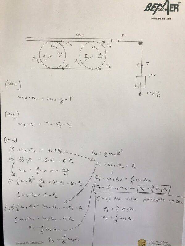

At first the system is resting and at some point we let m1 fall down. I need to find the forces (yellow arrows)
F = m*a
a = R*ß
torque = 1/2*m*R^2
Hi! I need help with this problem. m1-2-3-4 and R are given. There is no slip in the system. I have to give F1-2-3-4 in respect of the masses and R.
Here is what I managed to
m1 is easy: m1*a = m1*g - T(tension of the rope)
m2: m2*a = T - (?) <-- I have a problem with this. F1 and F3 is the Force on the wheels "made" by m2. But if m2 rotates the wheels, then m2's acceleration is weakened by the wheels, right? How? I need "new"(red arrows, not given by the teacher) forces acting on m2?
I can calculate the rotational forces on both wheels with this equation: Torque*angular acceleration = R*F(1-3) - R*F(2-4)
I can calculate the horizontal acceleration with this equation: m(3-4)* horizontal acceleration = F(1-3) + F(2-4)
I think the edge of the wheel had the same acceleration as m1 and m2, but I don't know how is it related to the horizontal acceleration.
I found an equation: a = R*angular acceleration, but if I am correct this isn't the acceleration of the rotating outer edge.
What do you know about action and reaction?
Likes Hohen
Thank you, I know more about it now :)
So if I understood correctly: The red arrows are the reaction forces of f1-3.
m2 imparts f1-3 on the cylinders and the cylinders impart the reaction forces on m2. Can I assume those forces has equal magnitude as f1-3?
m2 ⋅ a = T - f1 - f2 ← Is this equation correct?
One equals F1 in magnitude, the other F3, yes.
Not quite.. is that what you meant to write or did you make a typo?
I meant to write this.
In your diagram the two forces between the rollers and the plank are F1 and F3, not F1 and F2.
Oh sh.. I made a typo indeed, sry :D
So otherwise is it correct?
If it is I know parametrically the acceleration of the plank. The rotational acceleration of the outer edge of the cylinder is the same as the plank's acceleration, right?

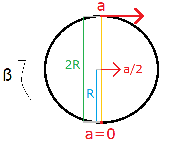

I analyzed a similar problem found on the internet. It said the horizontal acceleration of the cylinder is half as the rotational acceleration of the outer edge. Is this true? Can I start to deduce why?
Yes. What is the horizontal acceleration of the point where it touches the ground?
It's always 0.
Hohen said:
It's always 0.
Right. So if the horizontal acceleration at the top is a, what is the horizontal acceleration halfway up?
Then half of a but I still don't understand complitly.
I drew another picture:
ß is the angular acceleration.
So the equation a = R⋅ß gives me the acceleration in a point with R distance from point 0 (a = 0)?
Is this equation only true on the yellow line?
Is this somehow related to the x and y components of the accelerations?
Let the bottom point be a1, middle a2 and the top a3.
a(vector) = (ay; ax)
ay is centripetal acceleration?
a1 = (ay;0) → |a1| = √(ay^2 + 0^2) → the x component is 0
a2 = (0;ax) → |a1| = √(0^2 + ax^2) → the y component is 0, so the acceleration vector equals the x component
a3 = (ay;ax) → |a1| = √(ay^2 + ax^2) → ?

A safe way to consider the acceleration of a point on a rigid body is to think of the body's motion as the sum of the motion of its mass centre and its rotation about that centre.
Say a wheel radius r is rolling at speed v and linear acceleration a, and we are interested in the motion of a point at radius x, angle θ 'ahead' of the topmost point.
The angular acceleration of the wheel is a/r and angular velocity v/r. Relative to the centre, the point has tangential acceleration ax/r (forward and down) and centripetal acceleration v2x/r2.
Resolving into horizontal and vertical components, the point has net horizontal acceleration ##a+\frac{ax}r\cos(\theta)-\frac{v^2x}{r^2}\sin(\theta)## and vertical acceleration ##-\frac{ax}r\sin(\theta)-\frac{v^2x}{r^2}\cos(\theta)##.
