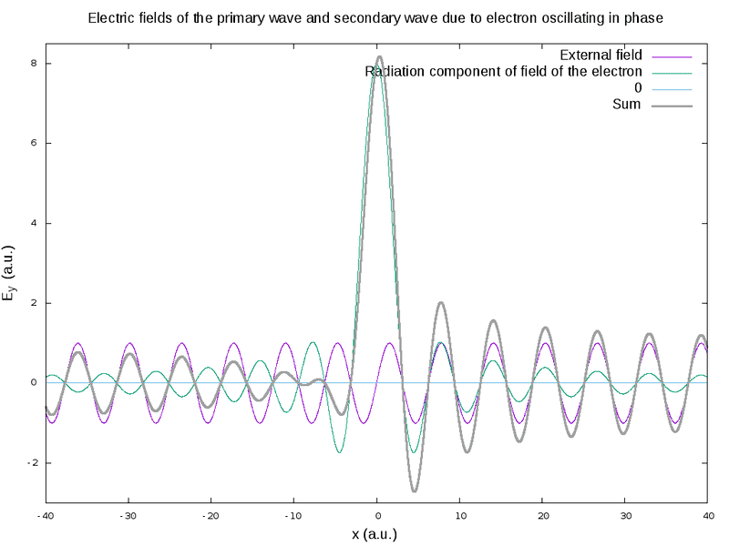

It can be shown that the radiation component of the electric field due to such oscillating electron, at a place farther down the line of propagation of the external wave, has the same sign as the external electric field. Thus the electron increases the total electric intensity in this direction on this line, "downstream". On the other hand, the electric field due to the electron on a half-line upstream now has two traveling waves of opposite velocity and opposite phase at each point of half-line upstream. Thus the electron decreases the total electric intensity on this half-line.
In the following graph, field of external linearly polarized wave (electric field has only y component) coming from the left (violet), the radiation field of the charged particle at ##x=0## (green) and their sum (gray) are depicted on the line of propagation at time when the force on the particle is zero. Notice how the field gets decrease in front of the oscillating particle but increased behind it. This is only one-dimensional view of things though; there are other points of the surrounding space where the field strength may be higher or lower. This is significant only in the vicinity of the electron; far from it, the external wave dominates.
