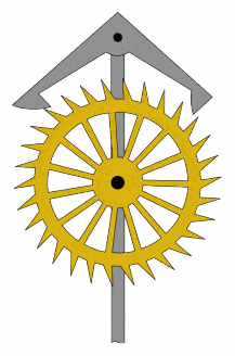

The mechanical way could be fun too. A wire rope, a pulley, a weight, plus an escapement gear and a pendulum would work well, and it would entertain your children and guests.
