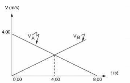

In summary, the two pieces of furniture, A and B, pass by each other at a certain point in time. It is known that the speed of B in relation to that of A has a certain value. I was able to find the acceleration of B by solving for Vb,a.
A13235378
50
Two pieces of furniture, A and B, run along the same line, in the same direction, in such a way that,
instant 𝑡 = 0.00 𝑠 the distance between them is 10.0 𝑚. The graphs of your speeds are
shown in the figure. It is known that the furniture passes by each other in a certain moment 𝑡𝐸> 0, where the speed of B in relation to that of A has a certain value 𝑣𝐵𝐴. We can conclude that:
V=Vo+at
S=So+vt+at^2/2
First, I calculated the acceleration of A by the slope:
-0.5m / s ^ 2
in t=4/s
V=Vo+at (To bodie A)
V=4-4.0,5
V=2m/s
With that, I was able to find the acceleration of B:
0,5m/s^2SA= 10 +4t - t^2/4
SB= t^2/4
I equaled the two, finding t = 10s
so, Va=-1m/s and Vb = 5m/s --> Vb,a = 6 m/s
BUT...
it's a matter of multiple choice and the answer is:
The problem as proposed has no solution.Why?
I know that I assumed that body A would be 10 m ahead, because only then would there be a solution to the second degree equation.

A13235378 said:
SA= 10 +4t - t^2/4
SB= t^2/4
The time can’t be 10s because the graph finishes at 8s. You don't know what happens after 8s.

My answer in post #4 is wrong. I thought A and B were moving in opposite directions but the question says they are moving in the *same* direction.
So the correct working is:
A starts at ##x_0## = 0m with u = 4m/s and a = -0.5##m/s^2##
##x_A = x_0 + ut + ½at^2 = 0 + 4t + ½(-0.5)t^2##
##x_A = 4t - 0.25t^2##
B starts at ##x_0## = 10m with u = 0m/s and a = 0.5##m/s²##.
##x_B = x_0 + ut + ½at^2 = 10 + 0t + ½(0.5)t^2##
##x_B = 10 + 0.25t^2##
When A and B meet at time ##t_E## then ##x_A=x_B##
##4t_E - 0.25t_E^2 = 10 + 0.25t_E^2##
##0.5t_E^2 – 4t_E + 10 = 0##
##t_E^2 – 8t_E + 20 = 0##
This has no (real) solution so A never catches up to B.
It goes to show how important it is to read the question properly. Desculpas pela confusão!
