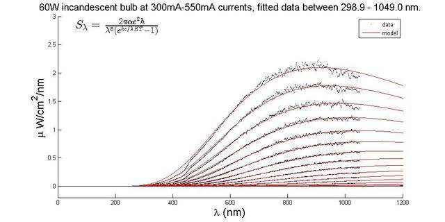

Thanks. I've been modeling their spectra, voltage, current, resistance, and temperature characteristics.

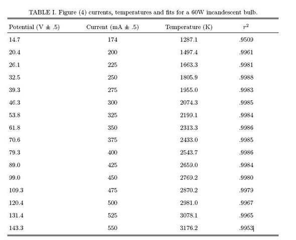

I want to cause the filament to fail, and I figured raising the filament temperature to the melting point of tungsten (~3683K) would do it. I calculated that I would need 141W using the stefan-boltzmann law, which translated into 211V after modeling the power as a function of voltage.
As you pointed out, I realize there are many more factors involved which I have not yet taken into account. But it's a starting point.

Since I didn't get my power supply yet, here's some pictures of our work so far to keep you interested...
Here are the data sets and models plotted: (disregard the title, as we took data between 174mA and 550mA... I just haven't gotten around to updating that)
and here is a table with the numbers:
