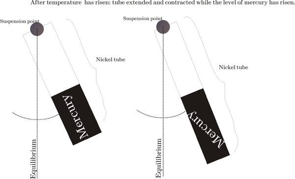

A small part of Nickel tube is fulfilled with mercury.
(Alpha) Linear coefficient of expansion (Nickel)= 1x10^-5
(Beta) Volumetric coefficient of expansion (Mercury)= 18X10^-5
FIND: What part of tube should be fullfilled, that the period of the pendulum would not depend upon temperature. And there is two different cases:
a) When centre of mass coincide with centre of Mercury in that tube.
b) Include misalignment of centres...
T=2pi(l/g)^1/2
deltaV/V=Beta*deltaT
deltaL/L=Alpha*deltaT
L=L0(1+alpha*deltaT)
V=V0(1+Beta*deltaT)
Should be more but don't know. Maybe someone could help :-)
Hello simon. Would you happen to have any form of diagrams? I am having a difficult time imagining this. What is the tube connected to? Am I to assume the tube is the bob? some more details on the setup would be nice
cases: a) the upper level of mercury should coincide with the mass centre of whole pendulum and b) it should not coincide.
Hello SimonasV,
Think about: what is "l" in the pendulum equation?
l=L - length of pendulum
That's true if the pendulum mass is a point-mass.
However, in this example the mass occupies a region of space. So how would we define l in this case? (Hint: it's the distance from the pivot point to ______?)
