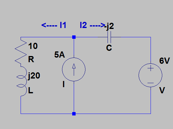

Find power absorbed by resistor, capacitor and inductor. Find the total complex power absorbed by all the loads.[/B]
KVL/KCL

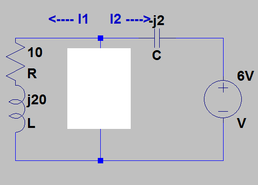

I want to solve this using Mesh analysis. There is a supermesh where the 5A source is, so I start it like this:
How do I assign the mesh currents? I1 and I2 are going in different directions.

You have been given reactances of the reactive elements while the sources seem to be dc. If you want to calculate the complex power, the sources must be ac. Is that the complete circuit diagram you have? Aren't the phase angles of the sources mentioned?
Sorry about that, the phase angles are 0 degrees.
You can assign mesh currents in any direction you like so long as you write the mesh equations according to the resulting definitions. That is, when you write the equations pay attention to the defined current directions. The alternative is to just apply your wrote procedure and then interpret the results in terms of the currents you "really" want. That is, extract your ##I_1## and ##I_2## from the mesh currents after solving for the mesh currents; signs imply directions.
-I1(10+j20) + 6V + I2(-j2) = 0
I1 + I2 = 5
Are these correct?
Yes, those look good!

I1 = (-15-26i)/53
I2 = (280+26i)/53
Correct?
Yup.

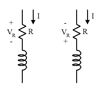

Just out of curiosity, would the voltage across resistor be -I1 * 10ohm because of the direction?
You need to specify how you will interpret a voltage before you even calculate it. That is, establish a reference point or orientation on your circuit diagram for interpretation of the voltage. Otherwise you can only talk about the magnitude of the potential change. When we write KVL equations, for example, we agree on interpreting the potential change in light of the arbitrarily decided current direction and direction of our "KVL walk" around the loop.
In the figure below, the voltage ##V_R## across the resistor would be positive in one interpretation and negative in the other. Yet it's the same potential drop. It's all in how you define the "measurement" on the circuit diagram.
