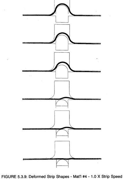

Nope. Grad student working on sheet metal forming about 1993. I had the experimental data, and needed FEA analysis. A number of papers on sheet metal forming had all used ABAQUS and the same element. ABAQUS has a huge book full of elements, so I just used the same element that everybody else used. I tested the software by simulating a tensile test. The FEA results matched the experimental results, so I went ahead with blankholder friction, then further steps until I simulated the full moving drawbead.
The FEA results differed from the experimental results by about 30%, plus the deformed geometry was wrong. A faculty member who had got his Ph.D. in sheet metal forming using ABAQUS with that element said it was experimental error. My error budget, and the deformed geometry said otherwise. So I dug into it and found that that particular element was not suited for sheet metal forming due to something known as hourglassing. I found a workaround that gave useable results. The longer models took over 200 hours CPU time on Sun workstations. These models ran in the background (graduate computer lab), so got about 16 hours CPU time per day. And the entire system was rebooted on the last day of every month.
Typical result of one FEA run. The solid black is really four elements thick, and is moving from left to right.
