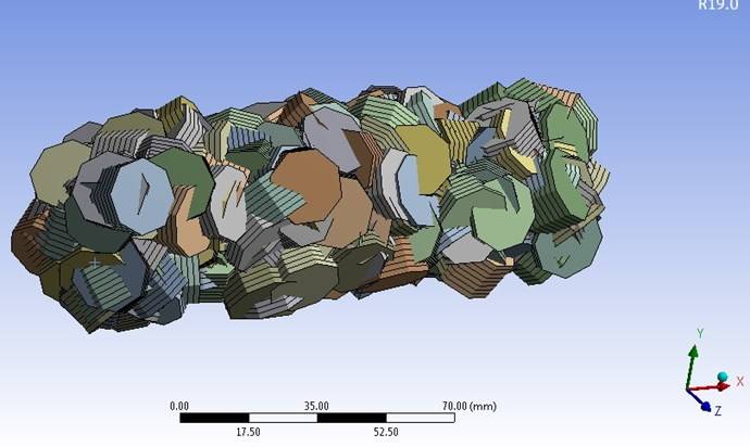

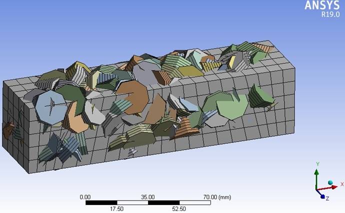

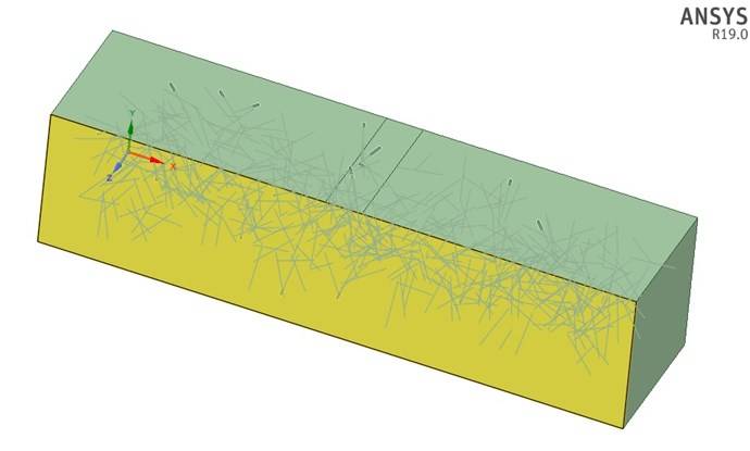

I designed two geometries (one for beam/line reinforcements and other second for a solid block shown below) in Ansys workbench spaceclaim for static structural analysis.
L8g7gfS
In Ansys workbench Mechanical, I got a weird mesh for the reinforcements which I modeled as beam in Spaceclaim (shown below in the first image). The mesh looked ok for the block (shown below in the second image along with the reinforcements).
ct933KL
I converted the beam elements to Link180 via APDL command. I ran the model but I had the following error,
A solver pivot warning or error has been detected in the UX degree of freedom of node 7206 located in Design2\Beam (Circle). This is usually a result of an ill conditioned matrix possibly due to unreasonable material properties, an under constrained model, or contact related issues. Check results carefully. You may select the offending object and/or geometry via RMB on this warning in the Messages window.
I think the geometry of reinforcement (beam/line) and block (solid) are not connected. I also tried Share Topology to connect node-to-node but still the problem is present. I also ran the Modal Analysis and I had the zero frequency result.
Can someone please guide me on this issue?

Why are you trying the mesh "reinforcement" method in the first place? What kind of simulation are you attempting?
