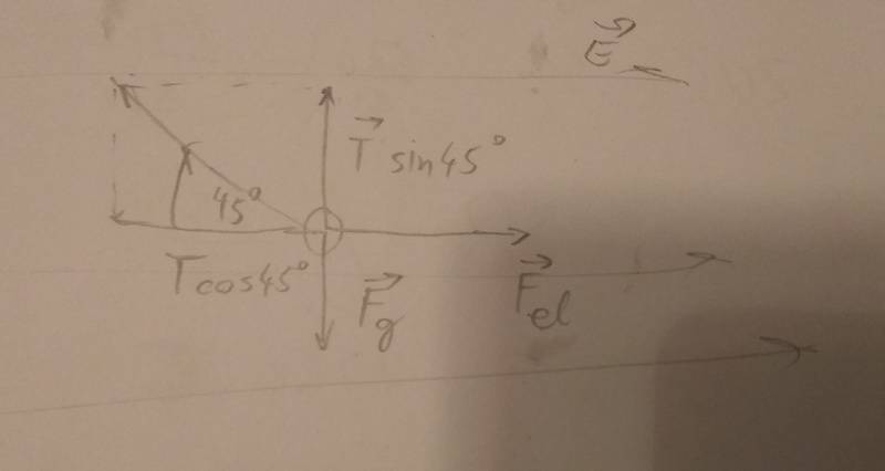

Charged metal sphere hanging on an isolated thread of negligible mass is put in a homogeneous horizontal electric field so that the thread makes a 45 degree angle with the el. field. What angle does the thread with the sphere close with the el. field after we remove 40% of the charge from the sphere?
1. ##F_g=mg##
2. ##F_g=T \cdot \sin(45)##
3. ##F_{el}=T \cdot \cos (45)##
I have provided image of force diagram.
I can substitute ##F_g## from equation 1 into equation 2 and get:
##mg=T \cdot \sin(45)##
Then I find expression for T in equation 3:
##T=\frac{F_{el}}{\cos (45)}##
and substitute it into second equation:
##mg=\frac{F_{el}}{\cos (45)} \cdot \sin(45)##
##mg=F_{el} \cdot \tan(45)##
I can express electric force as a product of electric field and charge of sphere:
##mg=q \cdot E \cdot \tan(45)##
I haven't gotten further than this. How do I show what happens with an angle when the charge is reduced 40%?
This equation looks good. Note that your derivation would work for any angle, not just for 45 degrees. If ##\theta_2## is the angle you are looking for, how would you write your equation with 45 degrees replaced by ##\theta_2##?
Well, I could substitute ##\Theta_2##:
##mg=q \cdot E \cdot \tan(\Theta_2)##
##\tan(\Theta_{2})=\frac{mg}{q \cdot E}##
##\Theta_2=\arctan \frac{mg}{q \cdot E}##

OK. Here ##q## is the charge corresponding to ##\theta_2##.
What do I do now? Do I just say that ##\Theta_2## is 60% of 45 degrees which is 27 degrees?
No. You have two equations, one for the initial charge ##q_1## and one for the final charge ##q_2##. Combine them to find ##\theta_2##.
OK, than:
##\tan 45=\frac{m \cdot g}{q_1 \cdot E}##
##\tan \Theta_2=\frac{m \cdot g}{q_2 \cdot E}##
##q_1=q, q_2=q_1-40\%=q-0.4q=0.6q####\tan 45=\frac{m \cdot g}{q \cdot E}##
##\tan \Theta_2=\frac{m \cdot g}{0.6 \cdot q \cdot E}##
##q \cdot \tan 45=\frac{m \cdot g}{E}##
##0.6 q \cdot \tan \Theta_2=\frac{m \cdot g}{E}##
I equate the two equations:
##0.6 q \cdot \tan \Theta_2=q \cdot \tan 45##
##\tan \Theta_2=\frac{\tan 45}{0.6}##
##\tan \Theta_2=\frac{1}{0.6}##
##\tan \Theta_2=\frac{5}{3}##
##\Theta_2=59^{\circ} 04'##

OK. Good work.
My calculator gives the answer as a decimal number of 59.04o.
.04 degree is about 2 minutes.
Considering that the 45 degrees is given to 2 significant figures, it would probably be best to express the answer as 59o or maybe 59.0o.
Likes steroidjunkie
You're right. It's 2 minutes, and not 4 minutes. Thank you very much for helping me.
