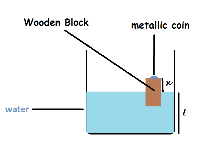

So there is some water inside a container; the height of water inside the container is l. I placed a wooden block on the water and it's floating to some height x, on top of the block is a metallic coin (see the diagram below).
What will happen if I throw that coin inside the water? Will the Height x and l change? Can we derive an expression for this change? I tried doing it, but failed.
Fb=gρhA
[/B]
Here is what I've tried Let's assume that our wooden block has mass m1 Volume v1height h1, height underneath the water as y and let's assume mass of Metallic coin as m2 Now total mass on block will be equal to (in which buoyant force is actin upon) : m = m2 + m1 and let's also say that total height h1 = x + y
Principle of buoyancy of a liquid is Give as : Fb=gρhA
Simplifying :
Fb=g(m/v1)(x+y)A ... {1}
Now, archimedes principle is given as F=gρhA
F=g(ρf - ρb)hA // ρb is Density of the Body
And then I am not sure what to do next .. Can anyone help me out?
Where ρ, h and A are what?
A - Area
ρ - density
h -
CaptCoonoor said:
h1 = x + y
CaptCoonoor said:
A - Area
ρ - density
h -
Sure, but of what?
haruspex said:
Sure, but of what?
Area of Wooden Block, ρb --> Density of Body
ρf --> Density of Liquid (water)
h is of Wooden block too
OK, but you previously posted
Simplifying :
If ρ is the density of the liquid, why do you have m/v1 there (where you have defined m = m1+m2)?
If h is the total height of the block, then Ah would be the volume of the block. If you multiply that by the density of the liquid, what mass will that give you?
Let me try to explain again:
Simplifying :
This is wrong. The buoyant force does not depend in any way on the mass or density of the object nor on any part of its volume that is not immersed. It depends on the density of the fluid and the volume of the object that is submerged (and gravity, of course).
The principle of buoyancy is Archimedes' principle. It applies independently of whether the set-up is static and of whether the object is fully or partly immersed. Your other equation should come from the fact that the block+coin float.
Didnt Realize it, Thanks .. Gonna rederive it
