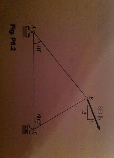

Using method of joints, determine the force in each member of the truss. State whether each member is in compression or tension.
joint method, I'm not sure how to describe it.
The answer is of course
Fab = 261.8 lb T
Fbc = 78.9 lb C
Fac = 39.4 lb T

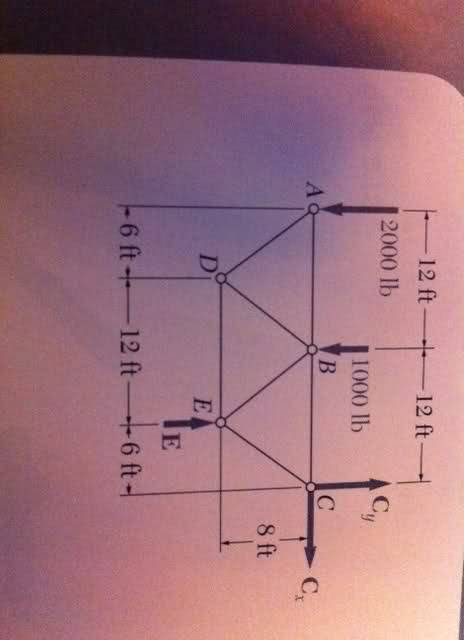

This is the example question I base my method off. To find Fab & Fad:
200lb/4 = Fab/3 = Fad/5

I get that Fcv=68.297 lb (up).
However, that is based on moments, which I believe is what you did. That's not the method of joints.
By the method of joints, joint B is in equilibrium (as are all the joints), so
ƩFx=0 → (FAC)cos(50°) - (FBC)cos(60°)+240=0
ƩFy=0 → (FAC)sin(50°) + (FBC)sin(60°)+100=0
(I chose the signs to assume each beam was under compression.)​
