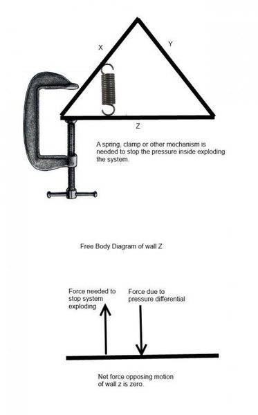

Hi guys,
It is not some homework, so I think it is better to post here. I would like to know if my method is correct for the work of the walls x and y.
I suppose no mass, no friction and the gas keeps its temperature constant.
An external device modify the shape of a triangle but it keeps constant the area. The external device turns the walls x clockwise around the dot O and the wall y counterclockwise around the dot O. The wall x rotates at the same angle as the wall y. At the same time, the external device moves the wall z up. Inside the triangle there is a gas and the pressure of the gas is higher than outside. There are gaskets between x/z and y/z: the gas doesn't escape.
I noted:
At start, a=b=√2/2 m and c=1 m
Difference of pressure P=1 Pa
Area of the triangle = 1*1/2 = 0.5 m² = constant
Calculation for an angle of 1e-1 rad
Depth of the device = 1 mEnergy from x and y :
The area is constant so a*b=0.5, so a=0.5/b
Pythagoras's theorem: c²=a²+b²
b=c*cos(α):
c²=0.25/(c²*cos²(α))+c²*cos²(α)
<=> (c²-c²*cos²(α))*(c²*cos²(α))=0.25
<=> c⁴*(1-cos²(α))cos²(α)=0.25
<=> c=(0.25/((1-cos²(α))*cos²(α)))^0.25
There are two walls but I need to divide by two (the moment), so the work is:
## \int_{\frac{pi}{4}}^{\frac{pi}{4}+0.1} (\frac{0.25}{(cos^2(x)*(1-cos^2(x)))^{0.25}} dx ##
Is it ok for you ?

Not that I can see. Apart from some effects due to turbulence the z wall is not moving relative to the gas because the volume is constant.
Work = pressure * change in volume.
No change in pressure or volume means no work.

Maybe we need to know more about the actual machine so we can help you ask the right question. Right now it sounds a little contrived so we can't come up with reasonable assumptions.
The walls x an y must be connected to wall z at the corners. Indeed something must provide a force between z and xy that counters the pressure difference or the seals will open or the system explode. When calculating the force on wall z you have to subtract these forces. You are left with a net zero force on wall z. Walls x an y pull upwards on z with a force exactly equal to the pressure differential. The result is it takes no force to move wall z.
See diagram.

Your calculations are not correct. Your physics is wrong so your maths is irrelevant. We've been trying to explain that to you for some time now.
Mary2100 said:
"or the system explode." An external device controls the walls. The walls x, y and z are independent.
They cannot be "independent". The pressure inside creates a force that pushes wall z and xy apart. The "external device" must counteract that to stop the system exploding. It cannot do that without also applying a force between z and xy. I refer you to Newtons third law.
If you disagree then please provide a diagram showing how the external device works. How is your "external device" different to the clamp or spring I proposed?

OK so wall z is controlled by a stepper motor. What is the body of the motor mounted on? Newton's third law requires that the body of the motor pushes against something or the output shaft cannot push against wall z. For example a car jack cannot lift a car without pushing against the ground.
"What is the body of the motor mounted on?" the motor of the z wall is fixed on the ground, the motor for the z wall is a linear motor or use a gear (the z wall moves in translation).
OK so both point O and the motor are fixed to the ground. They are not independent they both "brace" themselves against the ground. eg The pressure inside is ultimately resisted by the ground.
When calculating the power needed to move wall z this additional force must be taken into account. However because the ground force and pressure force are equal and opposite the net force is zero.

To calculate the power required to move any of the walls you need to consider all of the forces acting on the wall NOT just the pressure difference.
You have been ignoring the force that keeps the system together when it's not moving. I have explained this in post #18 and again just above. This force is provided by the clamp, spring or motor and is equal and opposite to the pressure force. So the net force is zero.
Therefore the power required to move the wall is zero.
Whatever you use (motors, clamps or springs) to stop the walls moving apart against the pressure difference consumes no power.
