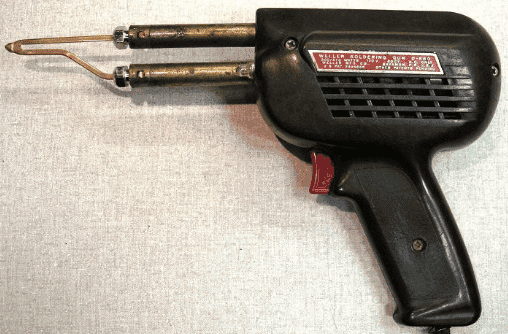

For more reasonable currents in a household experimental environment ,
buy a secondhand soldering gun to take apart and play with.
low voltage high current out of those two stubs.
Junk shops are full of them, around here they go for five bucks..
Heck. I still use mine.
I really need to visit that junk shop with a pocket full of money. :approve:
Me too. Great for car wiring - trailer lights, repairs,
and if you replace the tip with a coil of #12 solid you have a demagnetizer for hand tools tape heads and the like. . Worked great when an unshielded subwoofer underneath my Sony Triniton turned that corner of the screen purple. (today's flatscreens seem unaffected )

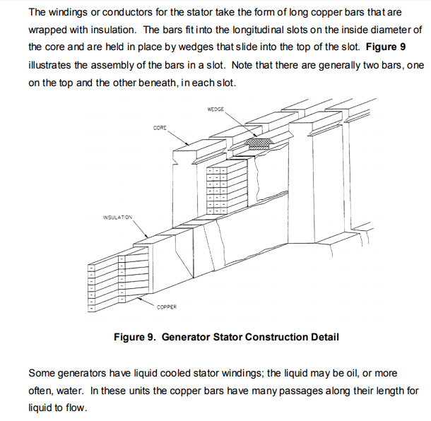

FWIW
Our main generator armature current was around 20 kiloamps. The armature conductors were made of square strands stacked together and insulated from one another so magnetic effects wouldn't push all the current out to the periphery by 'skin effect'. They left lengthwise internal passages through which hydrogen gas flows for cooling.

jim hardy said:
Haven't found a picture yet.
A bit of an advertising (sorry), but the main point can be seen here.
Likes jim hardy

Another useful repurposing is to supply the soldering gun with a variac, add an ammeter, and use it as an adjustable high current source to check whether motor starter thermal overload relays trip at their rated values. It can also be used to check the calibration of, and set up AC current to 4-20 ma/0-10V signal conditioners.

jim hardy said:
Current density is the limiting factor.
Waitaminnit ... how did my soldering gun end up into that junk shop?
Big boy stator!
It always impresses me seeing larger than life versions of things, whether its power plant e machines where you can walk around inside the stator or ship diesel engines where the ratchet to remove the cylinder head bolts is hydraulically powered and has its own crane.
