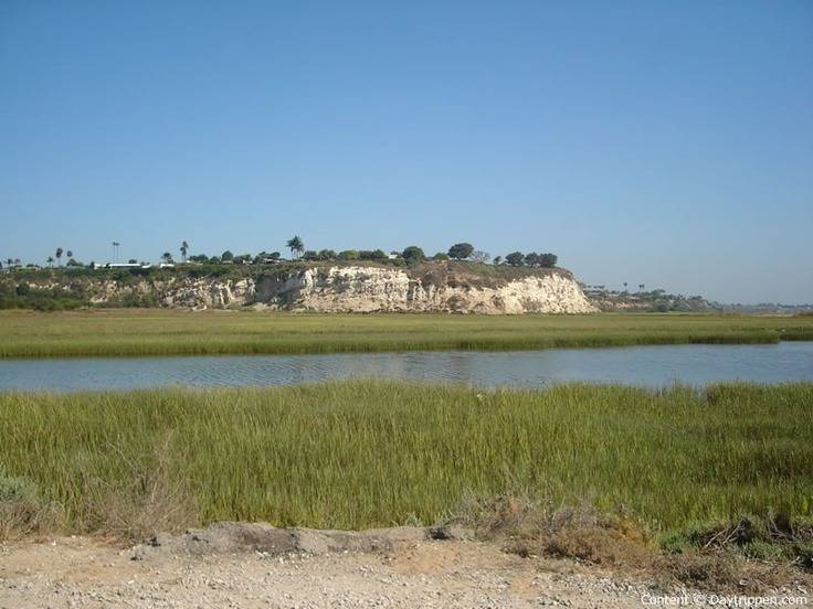

Are there any effective ways for preventing erosion that work on a long-term basis? I’m asking this out of curiosity because there is a cliff side that I live near that I have observed eroding for the past years and it looks as though it is getting rather serious. It’s like this: There is a saltwater bay connected to the ocean, and on either side of the water there are steep cliffs. The top of the cliffs are, in fact, locations for residential homes (the place is actually a pricey area to live). For as long as I can remember, those cliffs have been slowly wearing away. Eventually, the city placed geotextiles kept in place with sandbags and rebar, but this is doing no good. The last time I visited the bay, so much of the cliff had eroded so that the bottom of some of the houses’ balconies were no longer resting on ground (it had all worn away). Is there nothing that can be done? Planting vegetation would be an effort in vain, because the soil is mostly sand (which is probably the cause of so much erosion) and nothing hardly grows except brush and cactus (and even those appear to be dead). Adding retaining walls would be a huge production and an eye sore for everybody, as well.
Southern California hardly gets any rain, but even light drizzles seem to do damage to the cliff. Is there seriously nothing that can be done? Or are there any options that the city just has not implemented?
There is no cost-effective way to prevent erosion of the cliff by the normal action of the sea and the wind.
You could, in principle, protect the cliff by cladding it in a hard material - that material will erode instead, hopefully slower. You can also keep rebuilding the cliff, establish a sea wall, that sort of thing. Planting stuff on the cliff speeds the erosion - tree roots break up the cliff face. Planting along the top of the cliff, or digging culverts, could reduce water run-off over the cliff ... but that probably isn't the main cause of erosion.
Basically, people with cliff-top properties are dicing with Nature - the trick is to sell up before the cliff erodes the property value as well.
I live near the kind of place you describe, the city council requires the erosion rate to be taken into account for any new constructions, and that figure is part of the mandatory disclosure.
Sometimes the rate of erosion is increased my human activity - people cutting steps into the cliff, for example, and rats tunnelling along the bottom.
Bottom line: you cannot stop the erosion. The best you can hope for is to slow it down.

Thanks for you're reply! I think understand why nothing has been done to the cliff near my home now: because there's nothing to be done :(
My parents grew up near Galveston, TX, and at one time had considered buying a beach front home. but my parents did some research and found that the current homes on stilts on the beachfront were hundreds of yards in from previous homes on stilts that had been wiped out by a previous hurricane. They decided not to buy, and that summer a hurricane hit and that entire subdivision was gone. The new shoreline was way inside of where the previous homes were. So, word to the wise, do not buy homes that are in areas that are likely to be erased. Sure they may have incredible views, until the views disappear, along with the Earth beneath them.

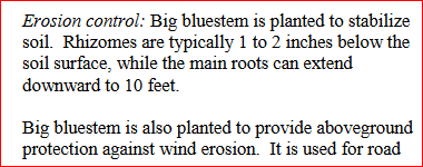

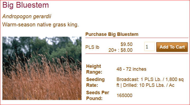

To your sandy cliff - will this stuff grow there ? It develops quite a root system.
http://plants.usda.gov/plantguide/pdf/pg_ange.pdf
Likes ProfuselyQuarky
ProfuselyQuarky said:
Do you think the city would mind if I planted some seeds on public property? :wink:
I only hear about California in the news...
Big Bluestem is native to America , but i think not California.
its relative Little Bluestem is a suggested antidote for invasive Japanese Silvergrass.
https://www.nps.gov/plants/ALIEn/pubs/midatlantic/plants-to-watch.htm
It too is used for erosion control.
http://plants.usda.gov/plantguide/pdf/pg_scsc.pdf
I would find my county agricultural co-op and ask them.
It's almost an endangered plant so who knows - they might welcome it.
