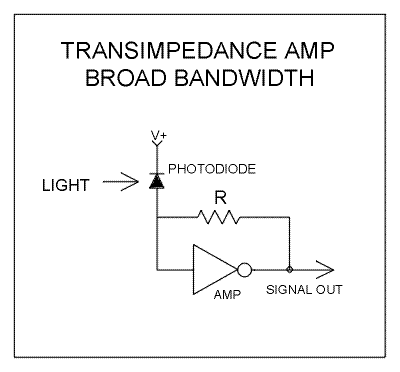

Long story short, I'm trying to "easily" increase the bandwidth of a transimpedance amplifier which is limited by the intrinsic capacitance of the feedback resistor, R. The knee frequency is of course given by f = 1/(2*pi*R*Cr), where Cr is the intrinsic capacitance of the resistor.
As of right now, the only thing I can think of is putting two (or more) resistors in series equal to the value of R to reduce the total capacitance, Cr. However, I don't know if this will actually reduce the capacitance or increase it since some capacitance will be created where the resistors are soldered together.
I currently have the PCB designed so the resistors are tombstoned or facing up with one soldered on top of the other. Is this going to work? I thought about actually trying it but I don't have a LCR meter that can measure in the tenths of picofarads. Are there other more conventional methods I should look at?
Could you put two resistors in series and a small bypass C to ground between them?
This would give a bit of top boost and may extend a bandwidth a bit.

Nope, I can't. One important aspect I should have mentioned is that the feedback resistor is in the gigaohm range and therefore leakage current is extremely crucial. Adding a decoupling cap could completely null out the feedback resistor.
What if the capacitor was a 3 to 30 pF variable? You are trying to reduce the AC feedback while maintaining DC stability.

I'm not really sure how making the cap variable is going to help. There's less than a pA going through that resistor. Adding something like a variable cap between the two resistors will completely wipe out my signal. I need a frequency range of ~250-1000Hz.

Less feedback means more gain.
I modeled this with a normal Opamp, not having details of your setup.
A 50 pF capacitor between two 50 K feedback resistors in series (with a 10 K input resistor) produces a marked peak at about 60 KHz.
If this coincided with an existing falloff in gain then it would produce an extension of bandwidth.

Here is my circuit and frequency response:
[PLAIN]http://dl.dropbox.com/u/4222062/opamp%20response%202.PNG
The yellow line is without the 32 pF capacitor and the blue line is with the capacitor. Makes a worthwhile improvement.

I did not mean to suggest discarding the transimpedance stage or its feedback resistor. What I meant was to add an equalisation filter later in the signal path, so as to flatten the frequency response over the required range. This may be only worth considering once you have exhausted the possibilities for extending the first stage response.
You should probably still consider modifying the transimpedance feedback. Splitting the feedback resistor seems reasonable enough - provided that only a fairly small resistance (perhaps tens of kohms) is added between the amplifier output and the split point. The remaining feedback resistor can still be large if this is necessary, for instance to get a suitable DC response, or if noise current matters more than noise voltage, so that paradoxically a huge load is actually preferable.
Finally, the point of using a variable capacitor would be to allow the response to be set up. You could just as well use a fixed capacitor if the optimum value were known.
